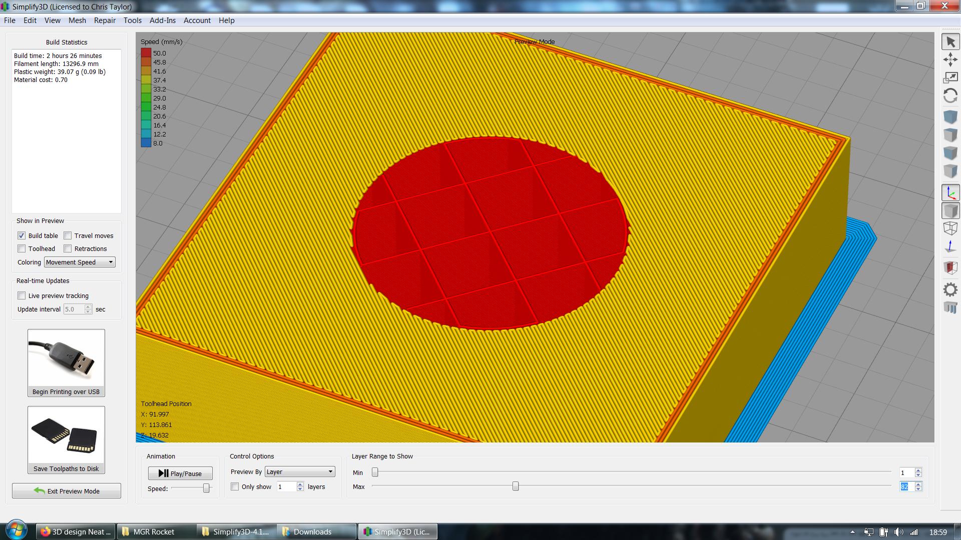

when it prints the solid layers first it does the layer first before the wall. that is just nuts since the layer now has nothing on X and Y to stick to. it just stops in empty space to end and start a line. combine this with it NOT stopping on top of an "infill line" and you end up with the ends of a layer in "mid air" so of course they warp and dangle. I sometimes have to add extra layers so that it "builds up" the layer over time going further out each time before it covers the area fully. while this fixes the cosmetic issue (at a waste of mass allotment and filament) it does NOT fix the structure integrity issues!! the part is "weaker" at this interface layer.
either print an entire solid layer at these interface points OR extend the "top/bottom" layer on X and Y such that it crosses over an "infill line" outside of the X Y area of the wall its about to lay down such that the wall HAS something to attach to and in the correct designated shape. to see what I mean design I have attached a demo file (factory STL and jpg) to demonstrate this slice flaw (yes I know its done intentionally. still a flaw just not a bug)
I INSTRUCTED the slicer not to do this. but it did it anyway. even if I place TWO objects in this configuration with seperate processes it still ignores my top bottom layer commands at the interface layer.
any solution to this currently requires me to waste mass allotment and or material to "overcome" the issue. (except on this the include solid layer under infill WOULD fix this!!!) but this solution has heavy annoying restrictions (and is sometimes ignored anyway) The only actual working solution is a REAL pain to impliment. I have to greatly 3 or 4 processes "leading up to" the interface layer and slowly increase infill percentage so I have dense infill by the time I get to the interface layer. in a model like I posted this is easy. in a model with 50 of these. forget it. not doing it. would literally take HOURS of editing processes !!!
in the picture is the first interface layer between the cub and the cylinder. this layer needs to be solid not open. as you can see a huge number of those layer lines have simply nothing to attach to at their end. the infill that is "curved" on the edges will also lack anything to attach to since the partial solid layer won't be their. it will have warped/curled away since it was printed in open space.
even 25% infill won't fully fix this and it would be stupid to use 25% infill on such an object. its just not needed except to overcome this slice flaw.
solution is to honor top and bottom layers (I used to retain an older version of S3D because it honored the instructions given to it in this regard using processes but you have since broken that work around and now it ignores instructions across processes as well.) and I use vase mode too much to keep using the older version which has vase mode bugs that you have since fixed (thank you btw works much better)
OR to print the fill "intelligently" ie each of those yellow lines for the top/bottom layers needs to be "extended" until they "touch something" so they will STAY where they are printed. this would not only save material but do so without compromising structure integrity.
