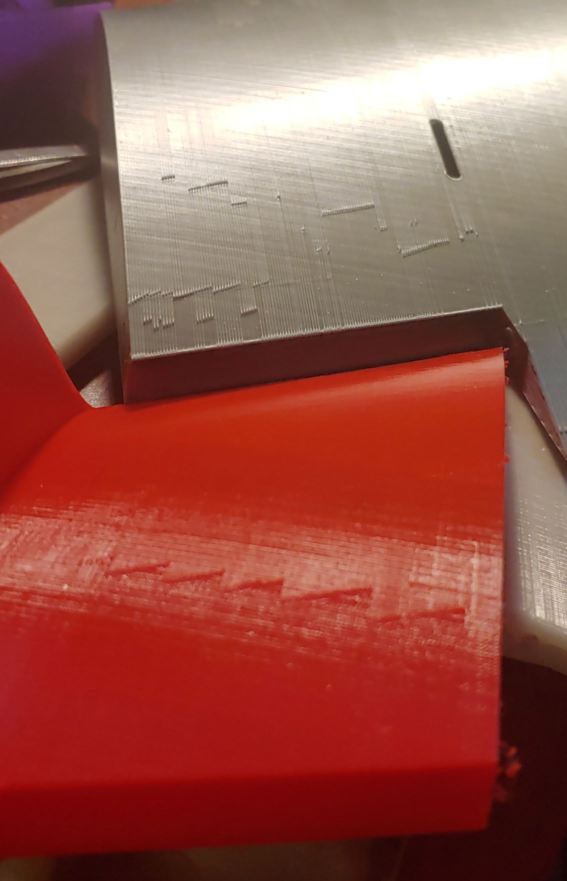

Slicer, coasting or start points
Is this a coasting problem? Or do I need to have randomized start points?
S3D-Alex
Posts: 456
Re: Slicer, coasting or start points
Random start points would just disperse the defects in this case. These look like classic retraction blobs so coasting or a little bit of negative extra restart distance are probably the way to go here. Since there is a 'corner' on these parts it may also be worth it to try and align the start points to that corner of the part as they usually blend in better at a corner than on a face.
