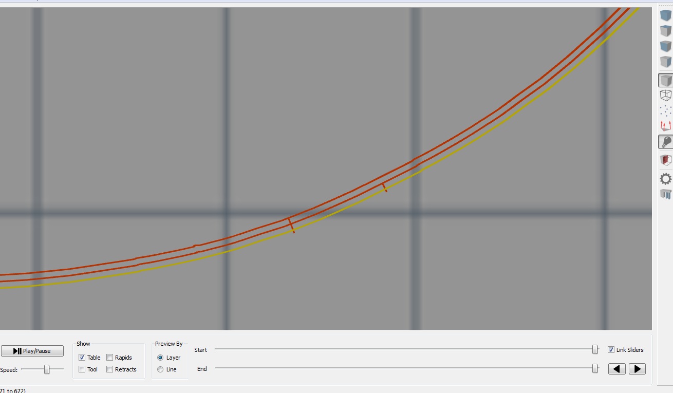

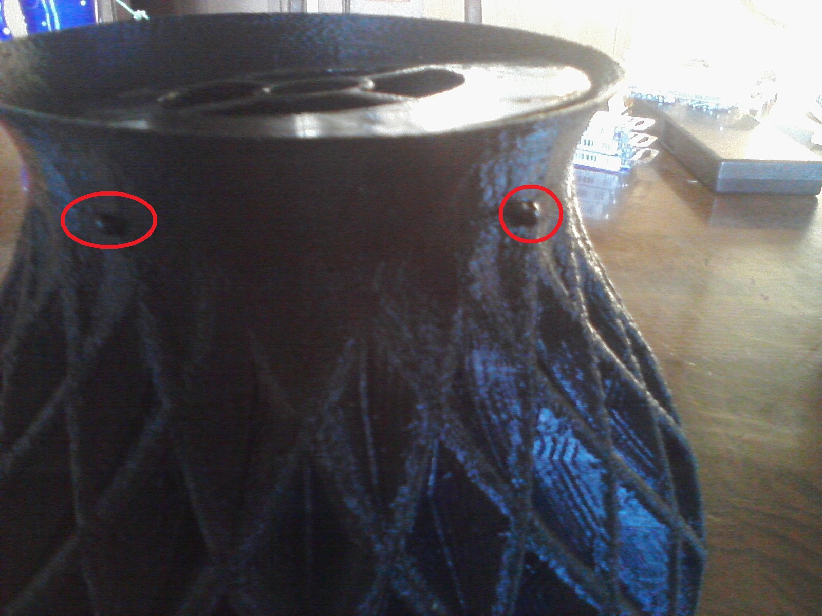

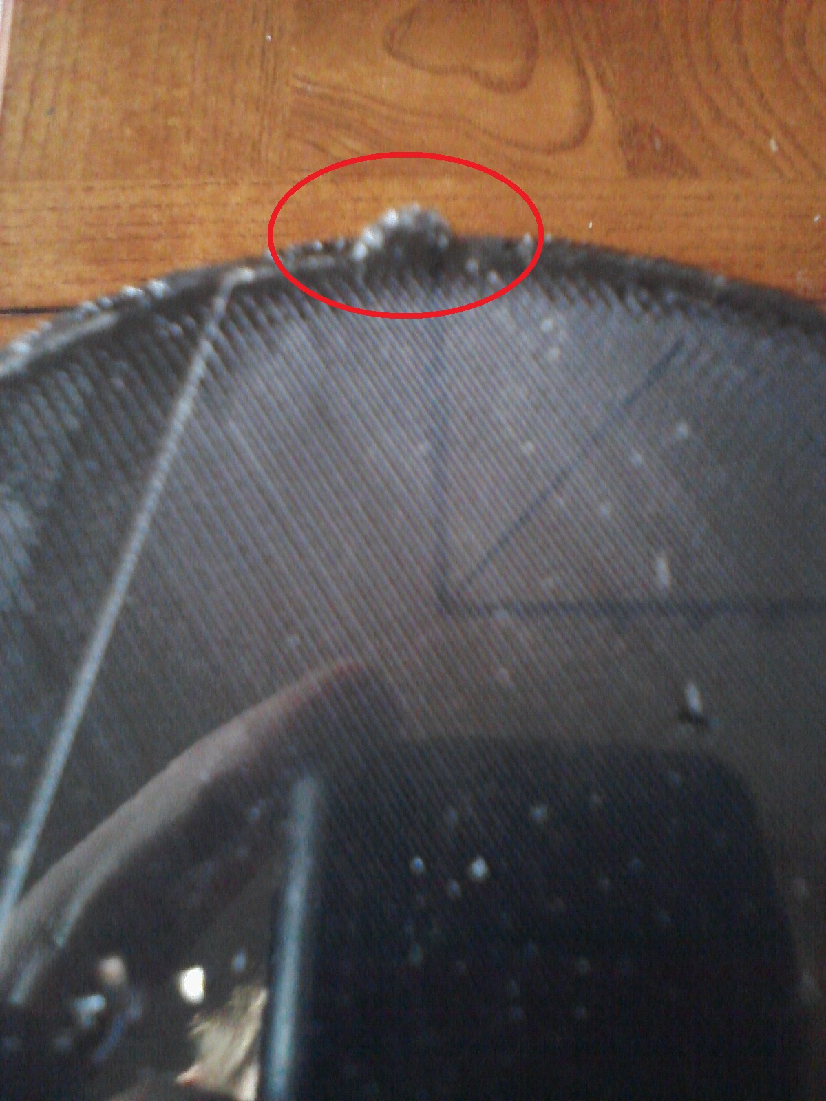

I can add a data point here...just experienced the same problem; see attached pictures. I watched it print on the first layer...the nozzle head stopped moving, but i saw it extrude a good amount...then it continued to move. It also happened at random points towards the upper region of the part. I definitely remove all blobs from the nozzle about 1 second before it touches the build plate to avoid any issues, so it wasn't that...
So you're saying the current fix is to uncheck the "replace with G2/G3 commands"? I printed several parts with earlier versions and no such trouble, although I think the G2/G3 was auto unchecked then?
Also... I noticed for most of my prints so far, when I look at the tool path preview I see some odd "cross-hatches" along what should be a perfectly circular section. See the other attached photo...this has shown up in multiple parts/settings/versions...for the particular setup, I was using no infill, 3x layers for the wall, and slicing this "http://www.thingiverse.com/thing:37327".
