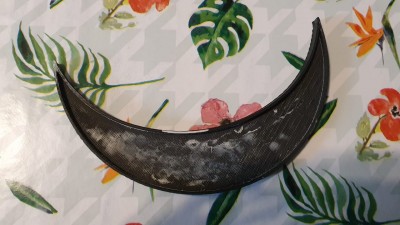

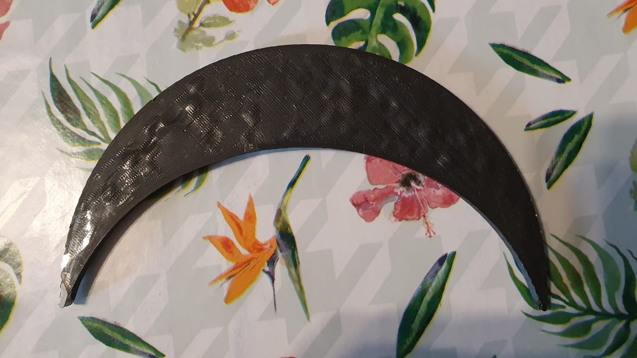

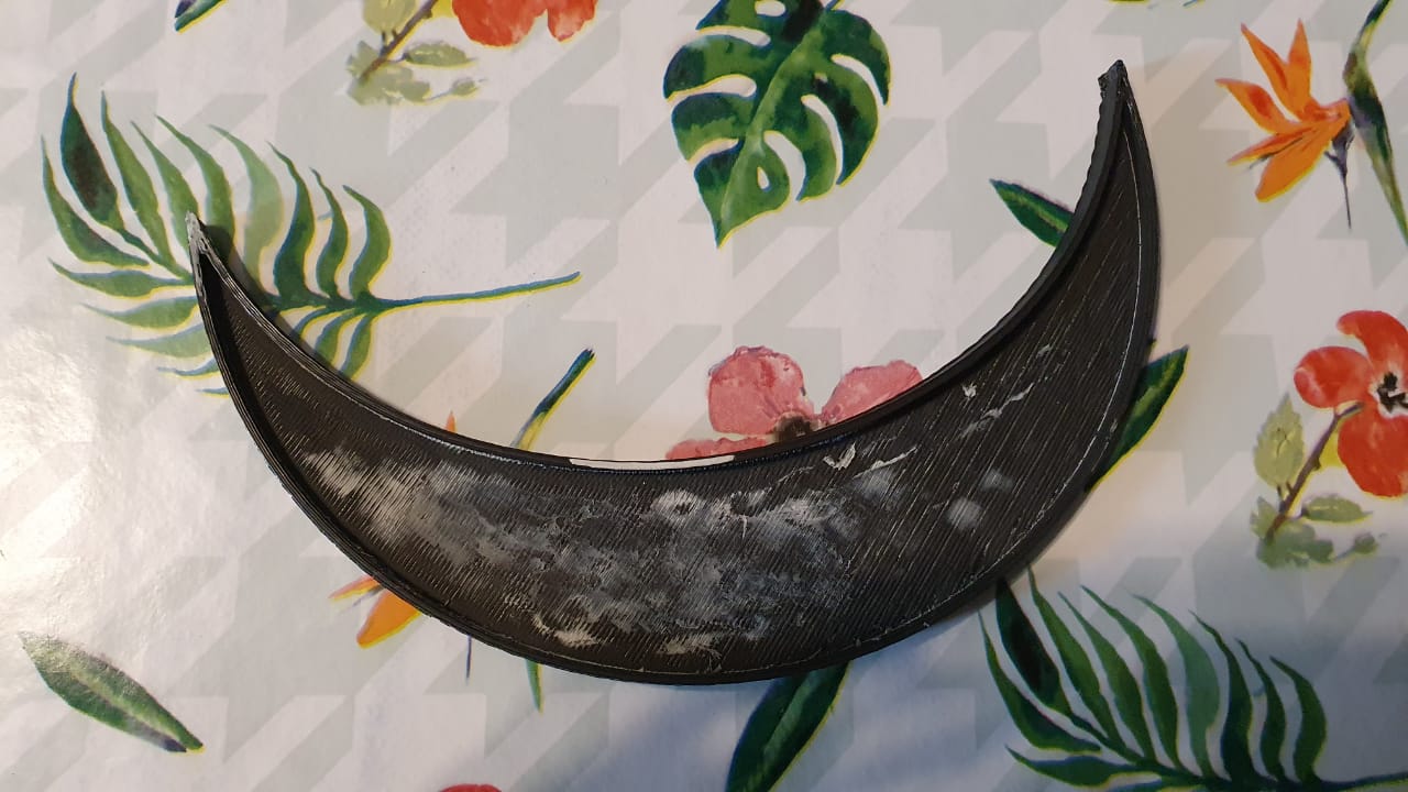

In my case, acetone does not soften the PLA, but renders the part structurally and aesthetically unusable. I am attaching two photos so you can observe the effects of a small bathroom.
