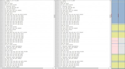

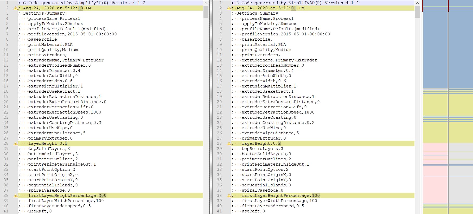

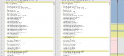

aiston wrote: ↑Sun Aug 23, 2020 7:42 pm So S3D does not push as much plastic for a 0.1 mm layer at 200% compared to a 0.2 mm layer.
Just checked this using a simple box. Layer height 0.2/1st layer 100% produces exactly the same
gcode as layer height 0.1/1st layer 200% does for perimeters/solid infill.
Only settings/comments differ until layer 2 starts...
Another thing you might want to consider if you don't want to adjust z offset might be using a
seperate process for the whole 1st layer.
