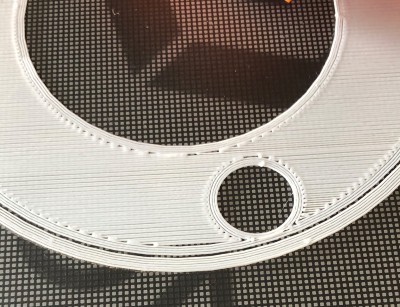

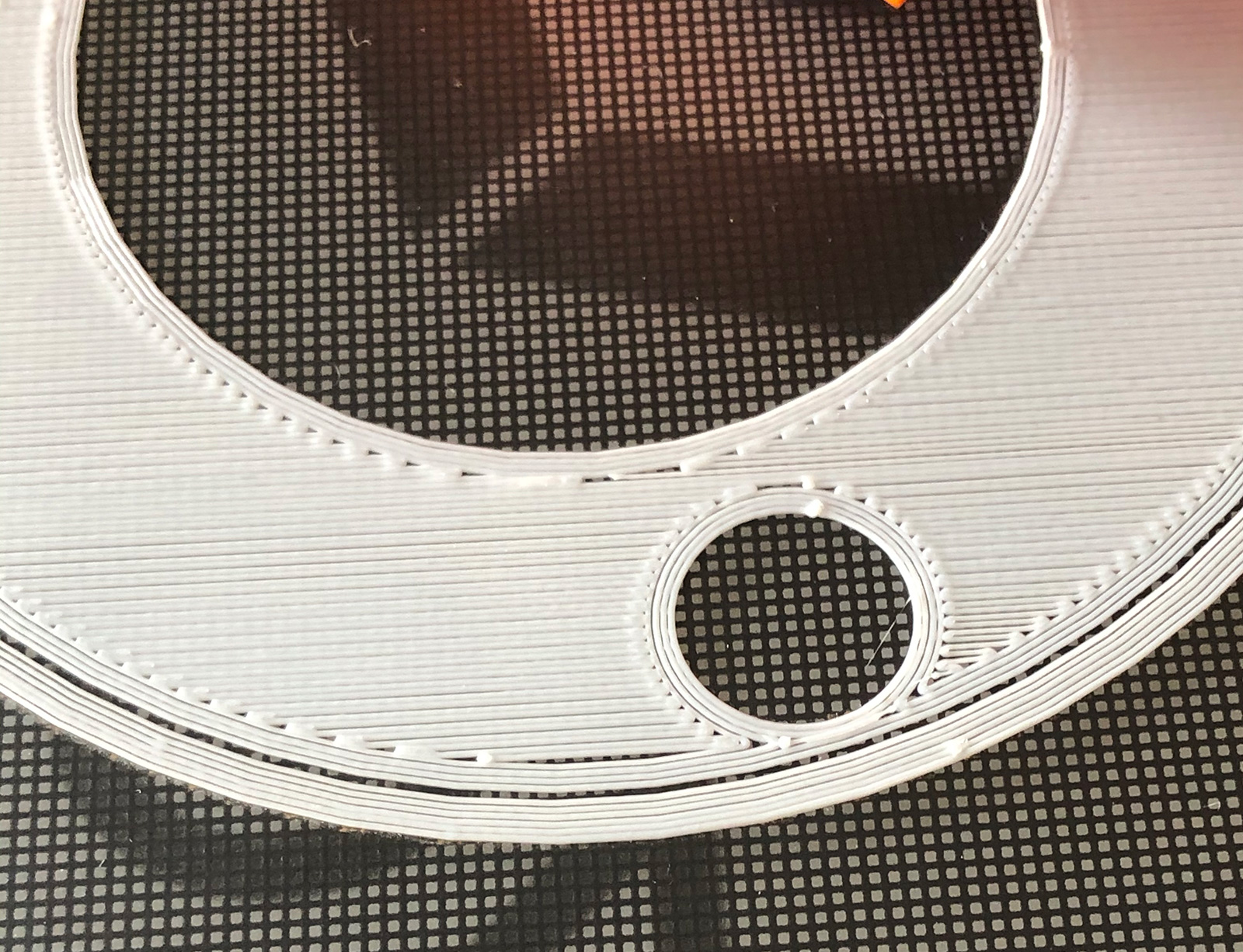

Here is a picture from my last print, during the first layer:
It's far from perfect... What settings should I change to get a better first layer?

The nozzle is too high.
zemlin
Posts: 434
Re: First layer not 100% filled
Reduce your bed gap so the extrusion spreads out more.
Jarhead
Posts: 9
Joined: Thu Oct 05, 2017 10:00 am
You want the first layer to kinda squish onto the bed.
Your bed isn't level. See how towards the bottom of that pic you can see the extrusion as almost lines of plastic? Not being squished enough.
Yet the top of the picture the layers are more flat and pressed into the bed.
run the bed leveling again ( if you use one) or lift that edge of the bed up if you level manually.
You can actually count 6 rows of the brim in that pic but I bet you can't on the top side of the pic.

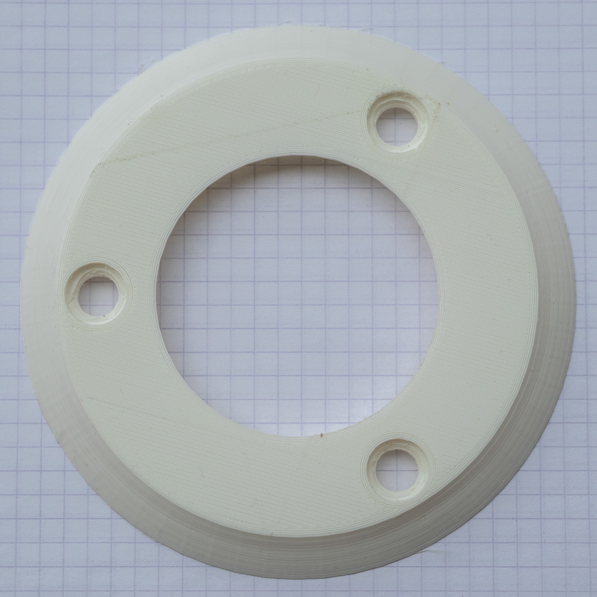

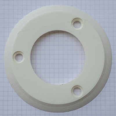

Thanks for your help. Here is a picture of the bottom of the piece printed:
I would say that the issue is the same all over the piece, don't you think so?

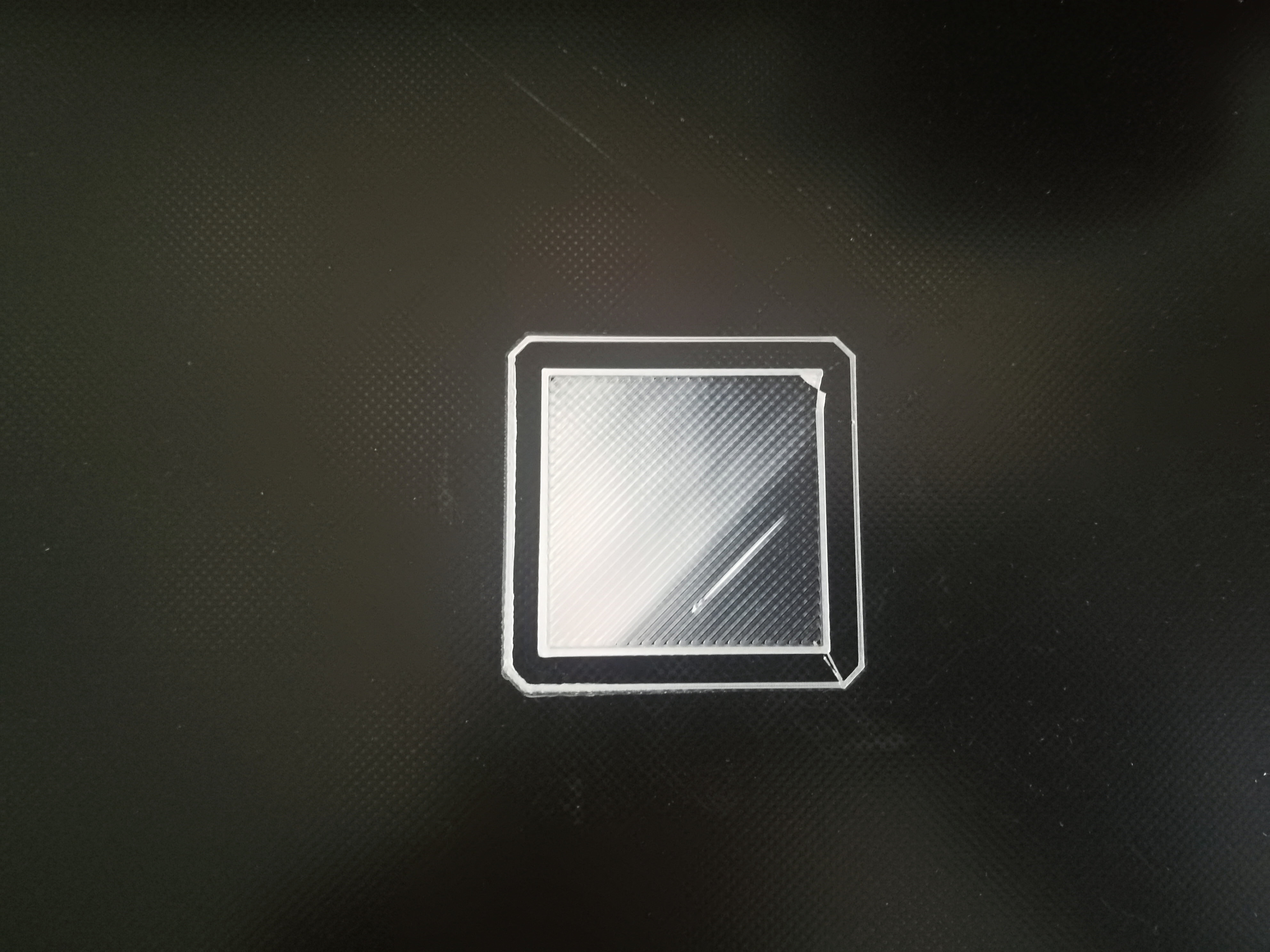

I think I have a problem similar to PatrickJ's.
I have a BLtouch and I added the G29 in the starting Gcode.
However, it seems that simplify3D does not take into account the auto-leveling because as you can see on the picture above I am more squashed on the right than on the left.
My bed has a hollow in the middle of it, hence the fact that I added the sensor.
Do you have any idea what the problem is?
The photo has been tested with a 0.1mm layer print with default settings.
Regards.

Seiphi wrote: Good morning, sir,
Regards.
You should ensure that your G29 command is after any G28 command, as the latter resets the levelling data.
