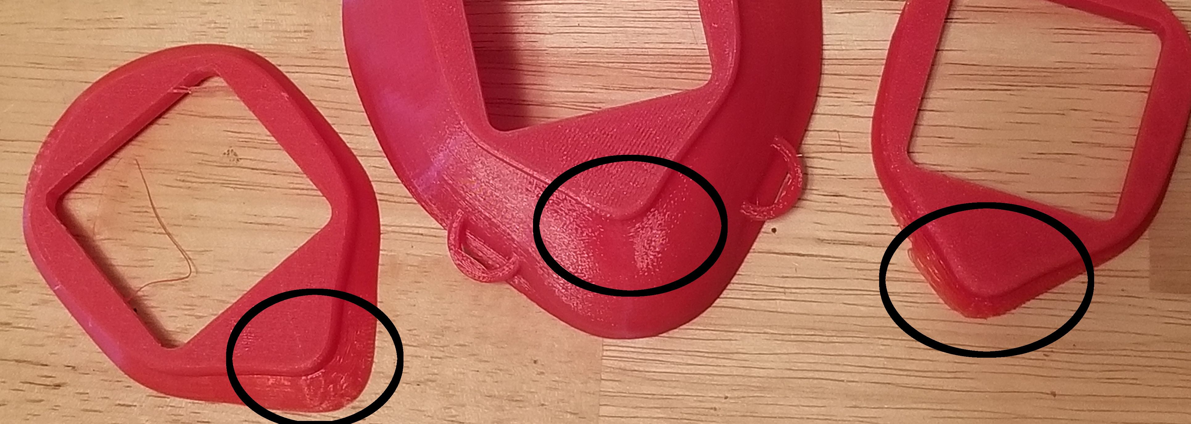

We have seven Flashforge Finder printers (plus others) running. six of the seven print the mask just fine. I can't figure the seventh one out, though. This is an example of what it does on the overhang making masks. The mask in the middle is from an identical printer, using the same gcode file, using the same filament type, brand and color (and received in the same shipment). All printers are approximately the same age (within about two weeks).
The other six printers handle the overhang very nicely. Just this one makes the droops and bad build shown here.
Any suggestions / words of wisdom? Any help would be much appreciated!

Looks like you have posted in the wrong forum, this is not a software issue.
Not much to go wrong with a finder. I would start with checking your nozzle, insulation, fan and PTFE tube.
