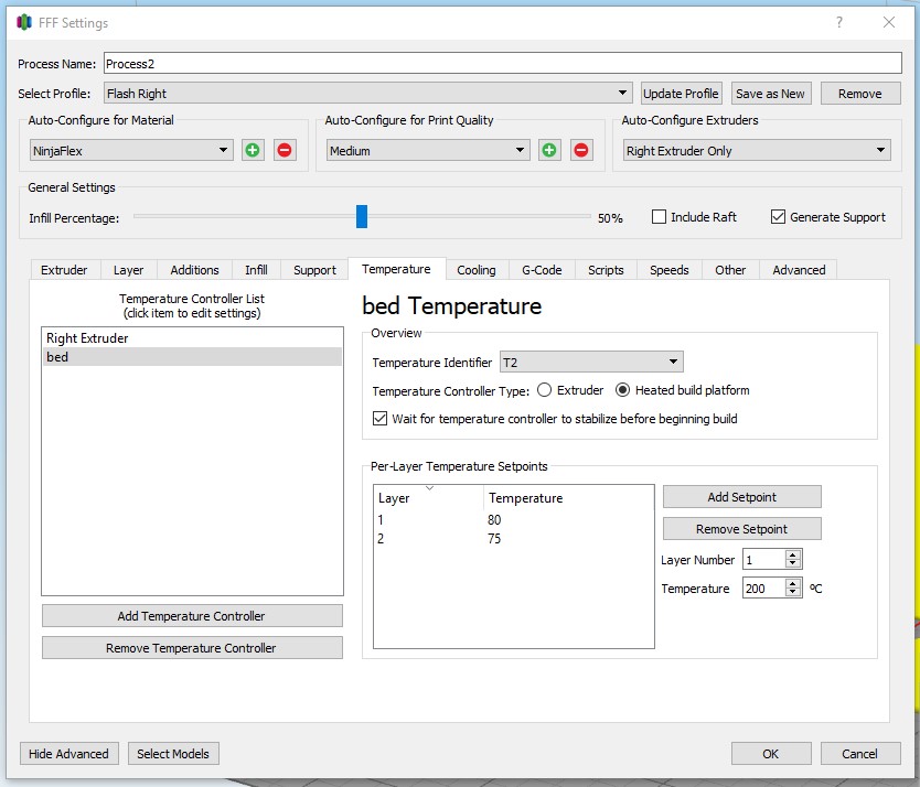

Hello! In getting my model ready to print, I am setting the bed heater to 80 for the first layer, and 75 after. However, when I go to print, only the extruder heats up, not the bed. I'm not very fluent in G-code, but it seems like there should be something in there. Here is a snippet of it:
Any idea what I might be missing? Thanks!

The bed should be T0. Is there a reason this is T2? It may be a good idea to reload the stock configuration for this printer. You can do this by going to Help > Configuration Assistant.
