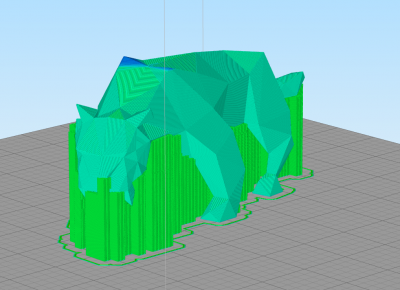

How tall is the tiger, looks like 45mm-50mm from the screenshot?

I'm printing it 76mm x162mm x76mm
I've just been using the default settings that S3D Setup for my printer mostly.
On Fast its 15% Infill, .3mm layer height

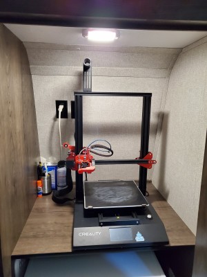

Here's my little setup. I live full time in a 5th Wheel so I re-purposed the Washer/Dryer closet as my little printing cabinet. I usually just leave the door cracked and it creates a nice little warm space so the printer heaters don't have to work so hard.
I think I am going to get some hooks to do on each side to hold the rolls of filament at some point to :)
Along with the upgraded coolers I have the TH3D upgraded fans for the boards inside and parts coolers and then I got a magnetic build mat and I changed out the Bed leveling sensor to a better one that was recommended

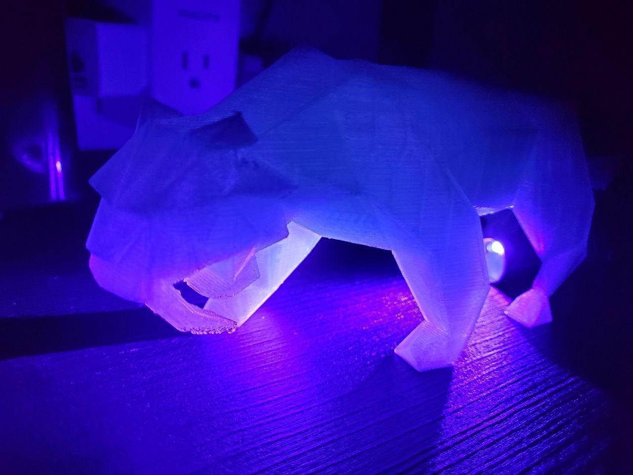

I think he came out pretty good. Just need to debur the support spots :) I used WYZ Clear PLA. He is going to sit on an RGB Header inside a PC Case so hopefully the colors will shine through some :)
