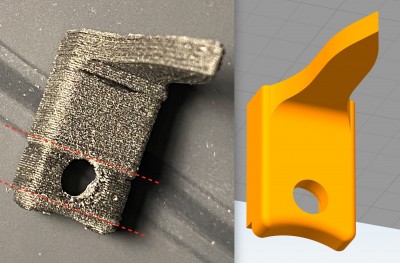

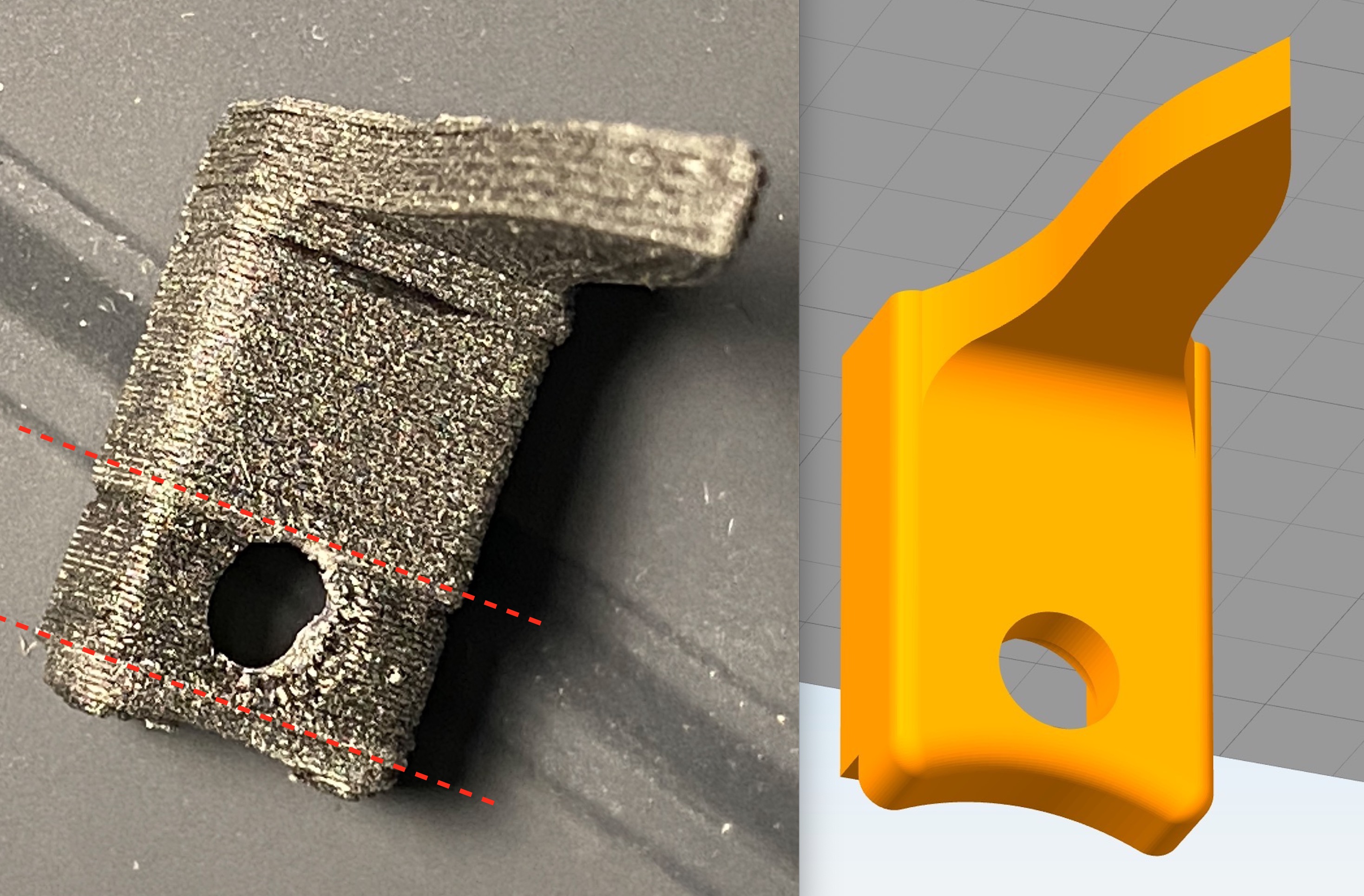

your picture show a darker and maybe a glossy finish in this zone
looks like it's print at lower speed in this zone so the filament had more time to heat and maybe less pressure in nozzle due to lots of retraction feature
if you look at your print speed in the gcode preview, this zone is probably darker blue than the rest of the part, if so your speed override is active
your part seem to be small if i compare the layers to the overall dimensions, that mean small print each side of the hole and less time to cool down
you said that you print multiple parts at the same time, so you have more retraction feature in this zone and more displacement too and by the way less nozzle pressure
maybe a different process in this zone with a lower nozzle temp can help you
or maybe just turning off speed override in this zone can help
but this is only suggestion, i didn't take time to experiment a lot in these kind of situations
