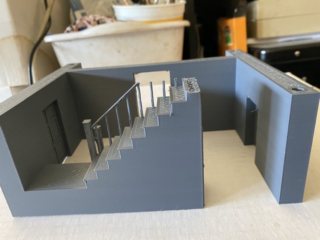

I am currently printing one room section of a house with my fusion 3 410 and I’m running into difficulties with the windows and stairs. I’ve tried lots of different settings with bridging and retractions but none of it seems to work. The panes always are very thin, brittle, blob up, shift, or just break. I’ve also tried manually thickening them in my modeling software but the result is the same. The stairwell actually printed ok except for the top not even existing, there was more filament so it did not run out so I have no clue what happened that the printer did not decide to print that part. Here is the factory file and some pics of the print

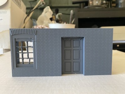

Here are some photos of the print with the problems, I think the door and the spindles printed alright, there are definitely issues but I think I can fix them.
The window is a complete anomaly however as sometimes it prints great and sometimes it comes out like above ^
I have tried placing supports within the panes which leads to even worse results. I think the issue might lie with retractions because I’ve tried everything else in simplify’s settings but still am unable to get a consistent results. I am basically certain that it’s not an issue with the structure but the print process itself but I have no idea where to start with changing the settings
