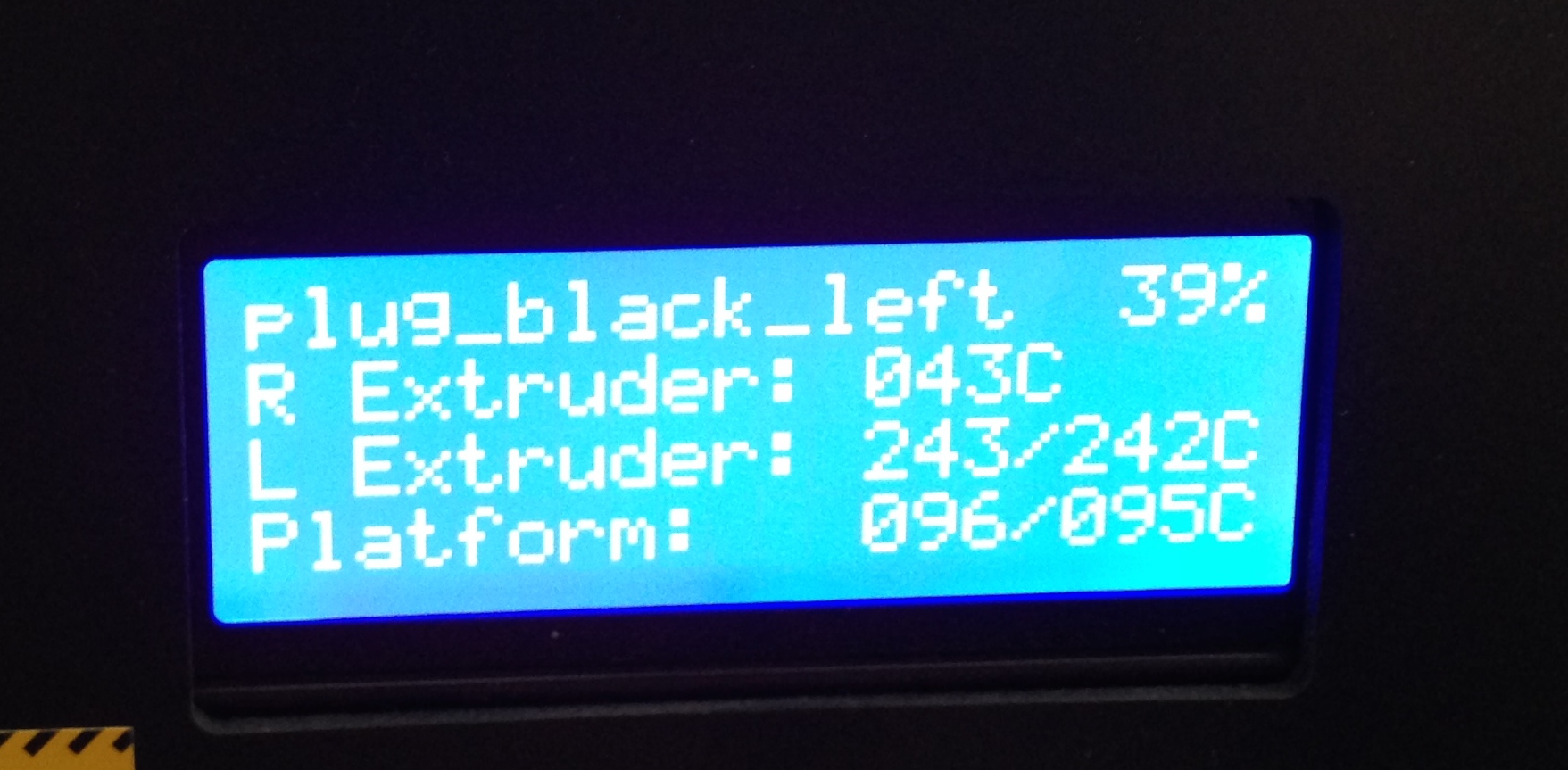

I don't know exactly where this bug lies. Maybe it's the fault of S3D or maybe some other issue, but it's consistent.
Anyway, attached pic is of the build progress immediately after the heaters warm up and the print is actually starting. Here is my start gcode...

Printer is Flashforge Creator X.
This happens worse the smaller the print. i.e. the smaller the print the larger the build percentage is at the start of the actual printing. So for this print it says 39%. If I print a large print it might say 4 or 5%, not as far off but not 0.
