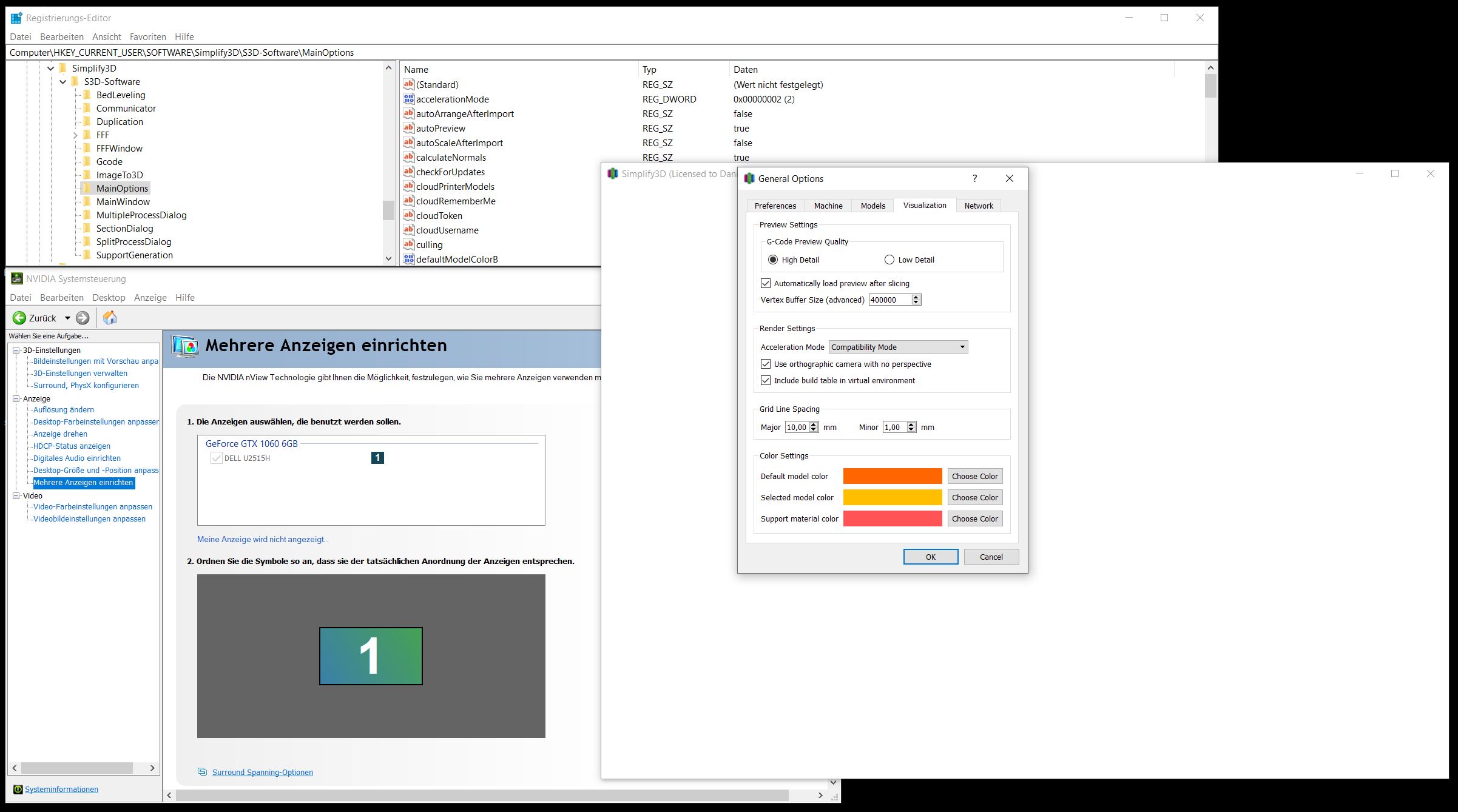

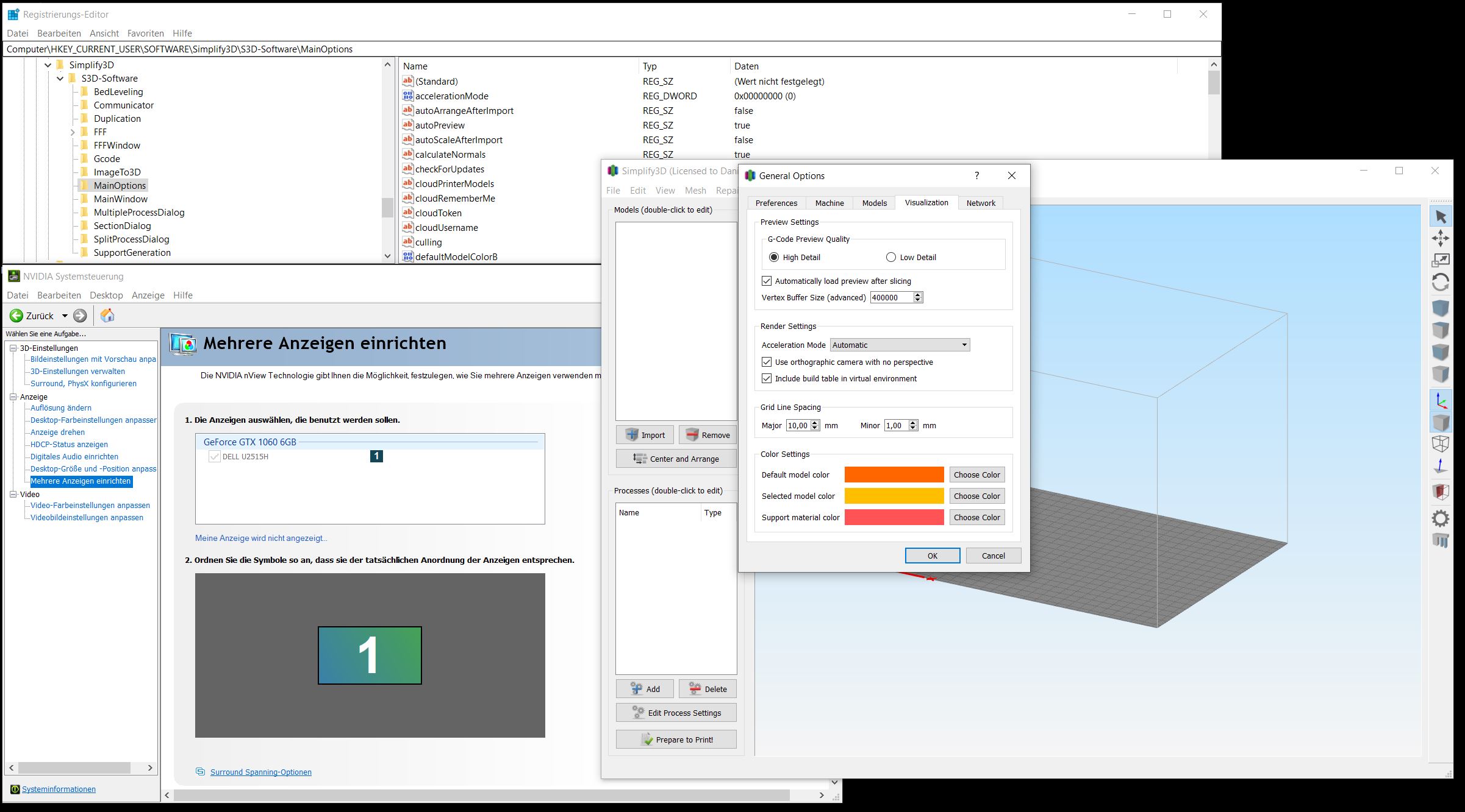

parallyze
Posts: 352
Joined: Fri Jun 05, 2015 4:18 am
Re: Simplify not starting after Windows 10 update
arhi wrote: Sat Jul 11, 2020 12:39 am
parallyze wrote: Mon Jul 06, 2020 11:00 am The only way this would affect the gl driver/graphics settings would be deleting the hive and not just the geometry keys inside.
I debugged this sh*t a lot so ... the issue is not only with s3d, the simplest way to reproduce it for me was with prusaslicer and since I have a source of that one...
The problem happens when you try to open a glwindow on non primary screen. When you open it on primary screen you can move it anywhere and it will work, but opening on non primary screen fails.
So to reproduce you just open a canvas on non primary screen and call wxGLCanvas::SwapBuffers(); this is pushed down directly to tne opengl driver call to swapbuffers and that's a call that will never end leaving you with WHITE screen as glcanvas was not initialized.
by deleting geometry keys s3d will start from the main/primary screen and there the wxGLCanvas::SwapBuffers(); works ok.
Take your s3d window and move it off primary screen. Close the s3d. Start it and it remembered you left it off-screen and will try to start there and you will have a white window.
If you do not use opengl but replacement api "angle" that's using directx you avoid the problem. You let QT know to use angle by using QT_OPENGL=angle env variable
Still all this doesn't affect what I've said:
If someone deletes the complete hive you can't say if it was the positioning/geometry keys _OR_ the selected graphics/acceleration mode. Because both settings are reset in that case.
While a white window may indicate the problem you've identified it may have been another problem caused by the selected acceleration mode. So unless somebody tries changing/resetting one setting after another you simply can't tell for sure.
If I select Compatibility mode using the old nvidia drivers I can get the white window-effect when there's not even a seconday screen attached to the machine at all. So there's only a primary screen available, still it looks exactly like the problem you described...
(Note: While the main window is all white you can still activate the menus by either clicking or using shortcuts)
Compatibility Mode / REG_DWORD 2
Automatic Mode / REG_DWORD 0
