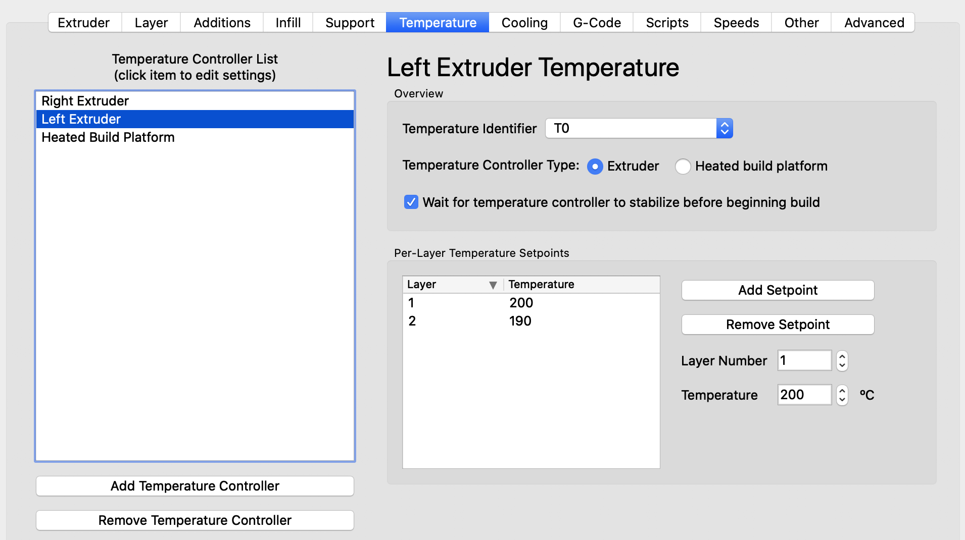

Here's my per layer temperature setpoints.

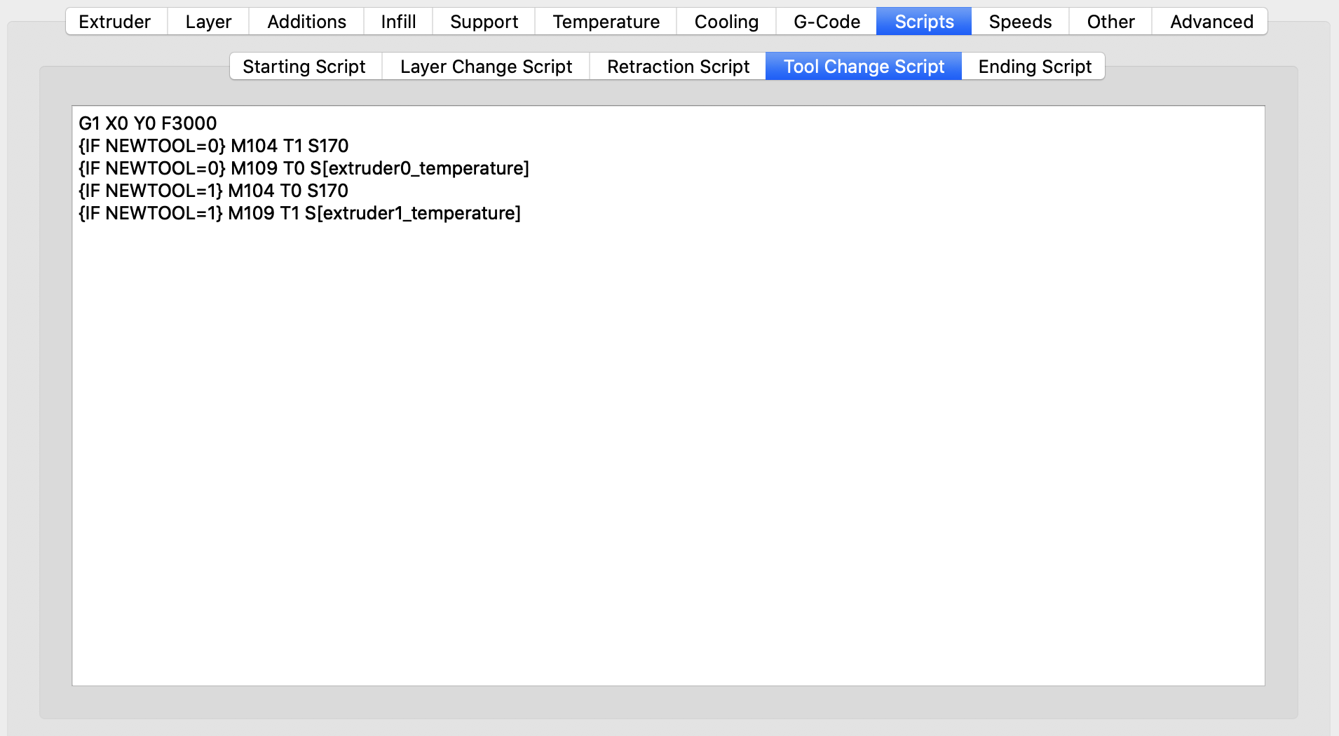

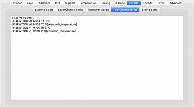

The tool change code works fine on all layers *except* for layer 2, where the temperature setpoint code appears to override the tool change script. I tried adding a layer change script to set the temperature, and it works, but it changes the temperature before the setpoint, and then the setpoint just changes it back.

I'm sure we can help you with this. Can you attach your factory file or show the lay set points for the right extruder as well? I don't see a tool change taking place in the cod you've shown so I'm not sure why you're saying it's overriding your toolchange script.
