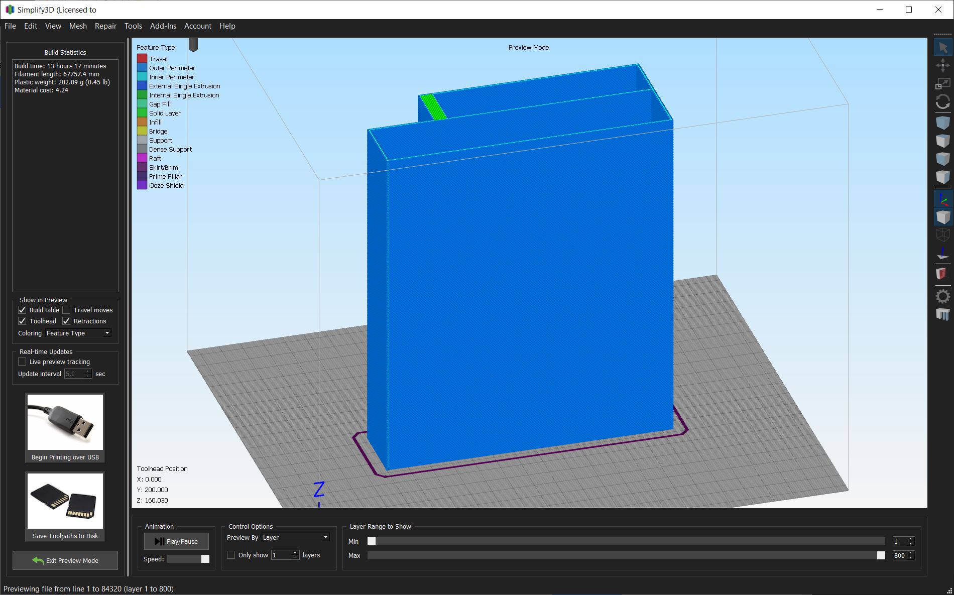

TomTinsley wrote:
I have looked at the layers 1 by 1 in preview mode and think layer 8 is where the support should start, but is instead doing only a wall which leaves open area and the next layer has nothing to attach to. Layer 7 finished the last base layer and 8 is starting the walls. I have attached a picture which also shows the print going outside the regular boundaries. The STL looked okay but maybe I missed something. This is the first time I have had an issue with printing anything.
wow, that's a quite long print at 45 hours. Have you considered printing this in another direction (bottom on the bed) and avoid support at all, is there a specific reason you'd like to print it like that?
If you attached a factory file (File -> Save Factory File as...) others can have a look at your settings/support options. But as far as I can tell from the gcode that's a very easy print when changing orientation.
