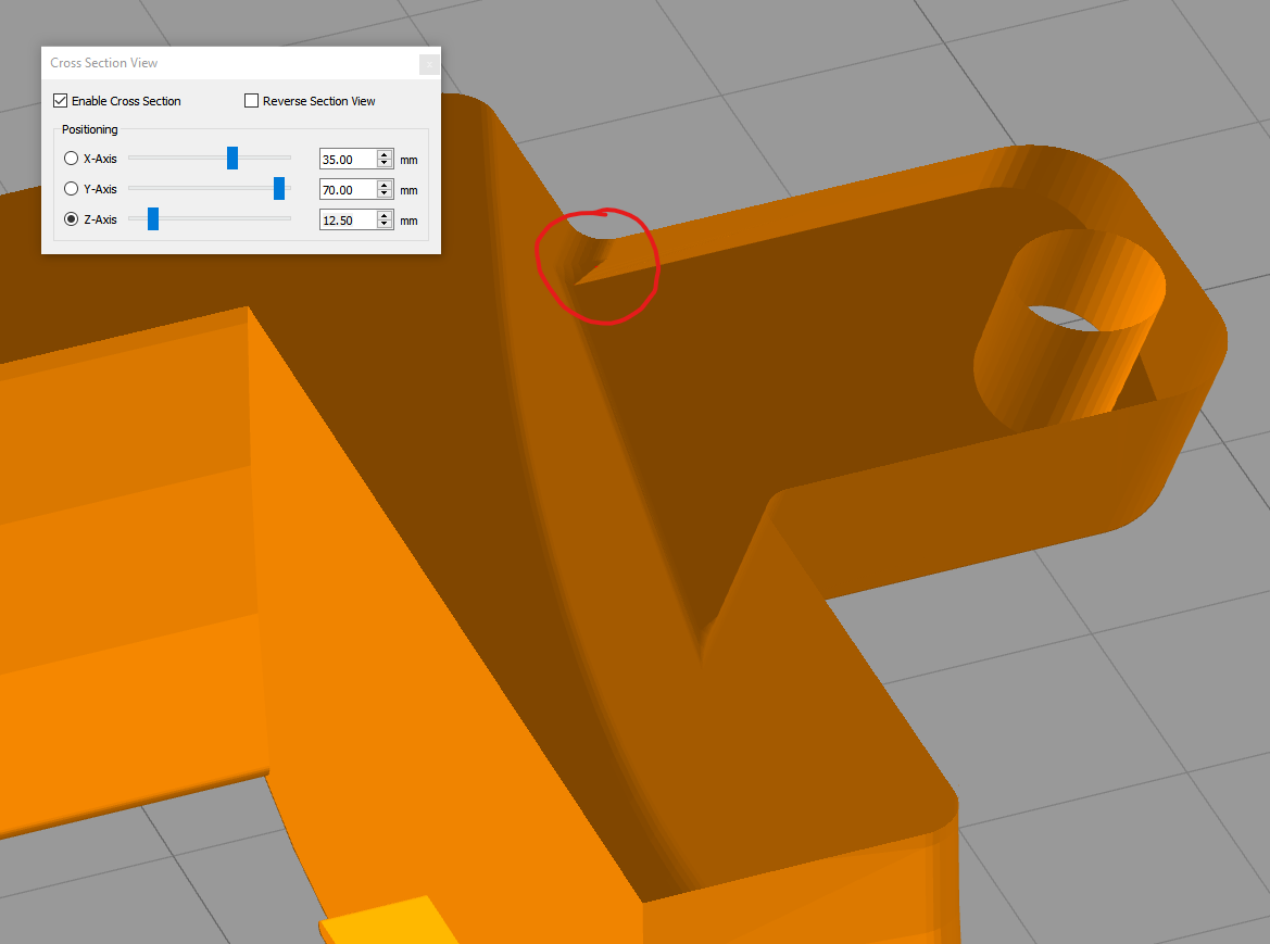

Can't fix self-intersecting problem
When I repair one of the models in S3D, the model is manifold but I can't fix self-intersecting problem. I tried to fix it in STL editors but they don't work. S3D is supposed to highlight the problem but I can't find the highlighted problem.
ED-013_D.stl
(835.73 KiB) Downloaded 183 times
S3D-Alex
Posts: 456
Re: Can't fix self-intersecting problem
I was able to find the errors here but they are admittedly pretty small so probably won't cause any print issues. I included a screenshot below showing where the error is with the cross section view enabled.

jeffmorris
Posts: 15
Joined: Fri Jan 29, 2016 6:40 pm
I used Autodesk Netfabb to fix the problems and 3D-printed the brake calipers without any problems. There were "holes" where you showed me the problems.
