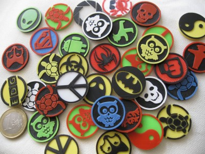

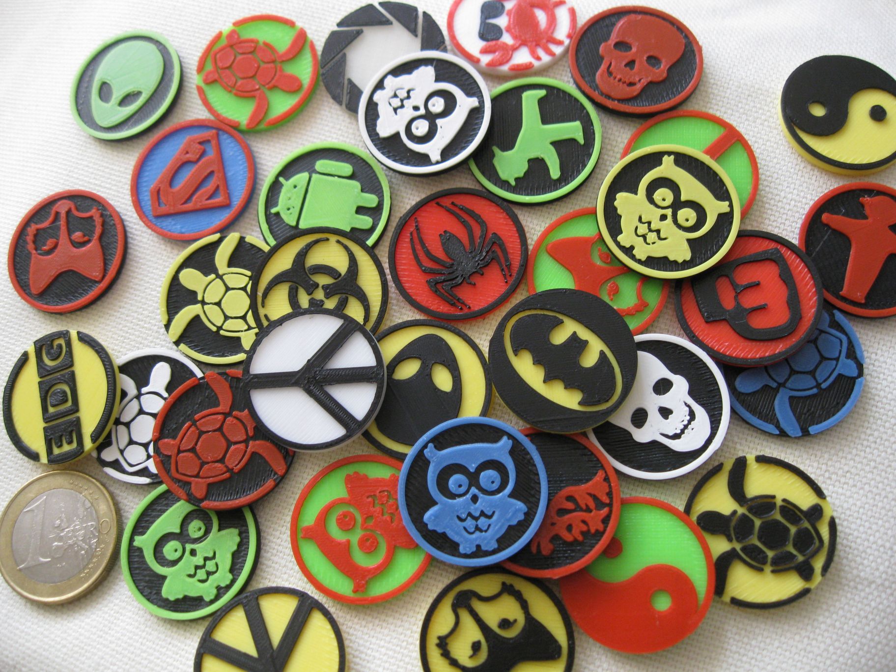

Look at my coins, aren't they pretty? Altough the new coins with the circular infill from that factory file I posted look even better.
I noticed you had the bottom with circular infill printed while the top layers had been printed using 32 outlines. Any specific reason for this? ^^

parallyze wrote: Thu Aug 27, 2020 5:38 pmI noticed you had the bottom with circular infill printed while the top layers had been printed using 32 outlines. Any specific reason for this? ^^
Yes, if I print circular infill on top, there will be a blob in the middle. I guess it's because of the hot nozzle staying in the same small area for too long. I need that slow printing speed for a nice surface, but slowly printing very small circles in the same small area just ruins it due to excess heat and then the blob will at best shine through the logo, at worst distort it.
So I want the center rectilinear to avoid that problem. I also noticed I can cover the entire layer with perimters printed inside-out. This will not create a blob in the middle, but that pushes the outer perimeter further out than it's supposed to be, so the top diameter is too big. I guess this is due to overextrusion, but if I lower the extrusion multiplier enough, there will be unseemly gaps between the perimeters.
So I print the perimters outside-in and have a patch of rectilinear in the midle that will be covered by the logo.
