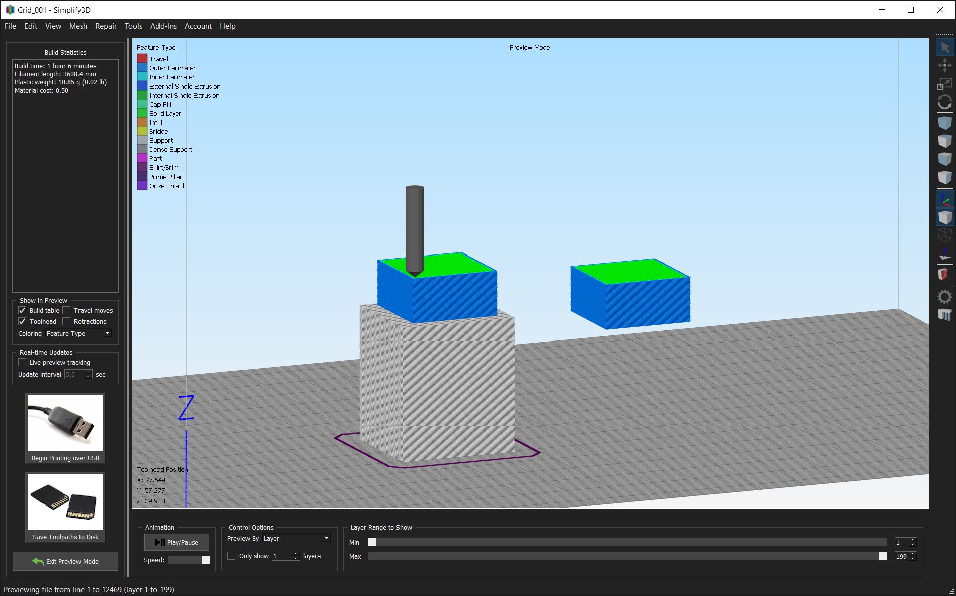

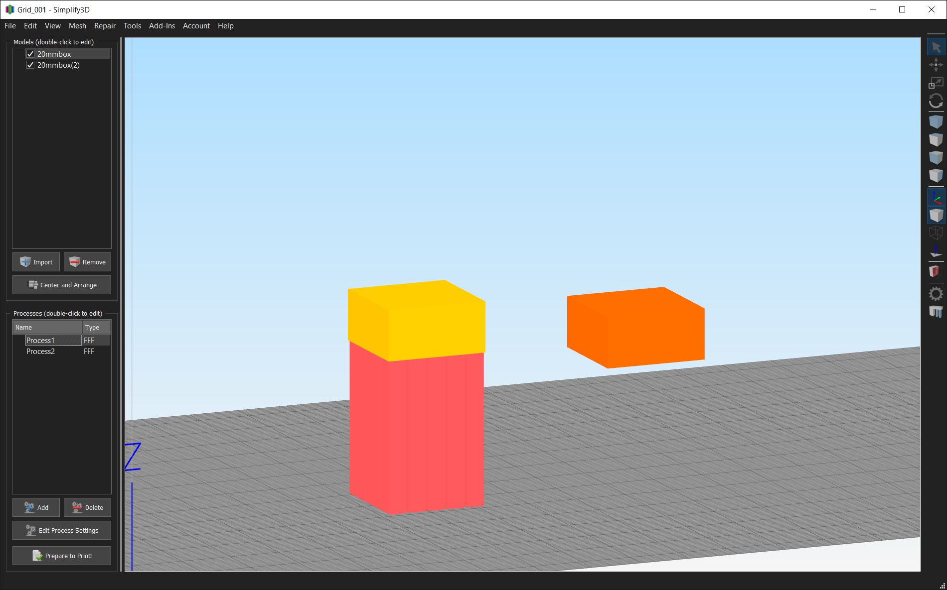

One thing you could do is add a second process with support generation disabled. Then assign the models to each process accordingly.
Edit:
Left -> Process1 -> Support Generation enabled
Right -> Process2 -> Support Generation disabled

calavera wrote: Thu Aug 27, 2020 1:31 pm About the different process method, I think processes can be divided horizontally, which means layer-based. So you can not separate two models side by side.
You can set up a process to start/stop at certain heights, yes. But you can also have different processes doing different models/settings side by side, that's what the "Select Models" dialog is for when editing a process...
As far as I understand this is a bug.
It's very simple to set up two processes with support on/off if there's different requirements for multiple objects... especially when adding/removing objects from the bed. Your proposal would mean one would have to edit/remove the automatic generated supports on each object not requiring them, just to make them work on another one.

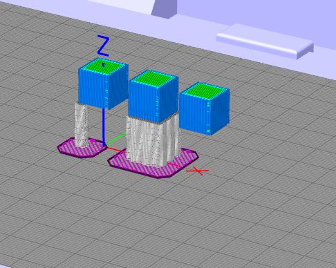

By default, set the support pillar resolution to 99. Then, for the part you want to generate manual supports, before you add the supports, set the manual support resolution to a sensible value .
At this point, if there is a part that you want auto-generated supports, in the manual support window, set the pillar to a sensible value and click the Generate supports. This will auto-generate supports manually.
Then, when you slice, any part that would trigger auto-generated supports will see a pillar resolution of 99....and not create supports.
This way, you get manual supports when you want them, you get auto-generated supports (created manually, but that's no sweat cos its just clicking a button! ), and no spurious auto-generated supports.
EDIT....

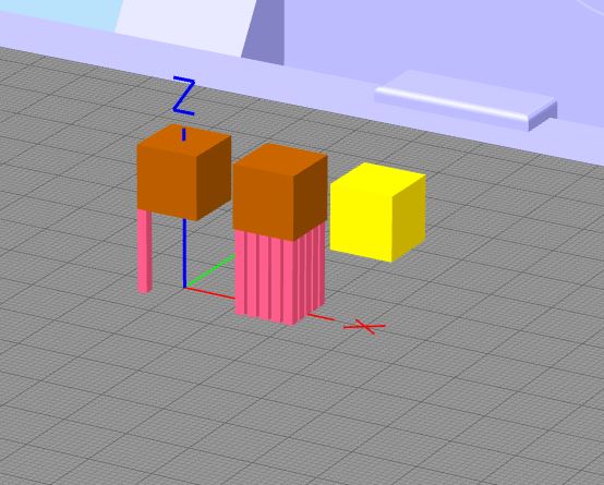

Some screenies to illustrate.
Left cube has manual support, middle cube has Auto-supports manually generated....both with pillar resolution at 2.0
Right cube has no manual supports.
In the profile, Supports are turned on and the pillar resolution set to 99.0
And here's the result:
