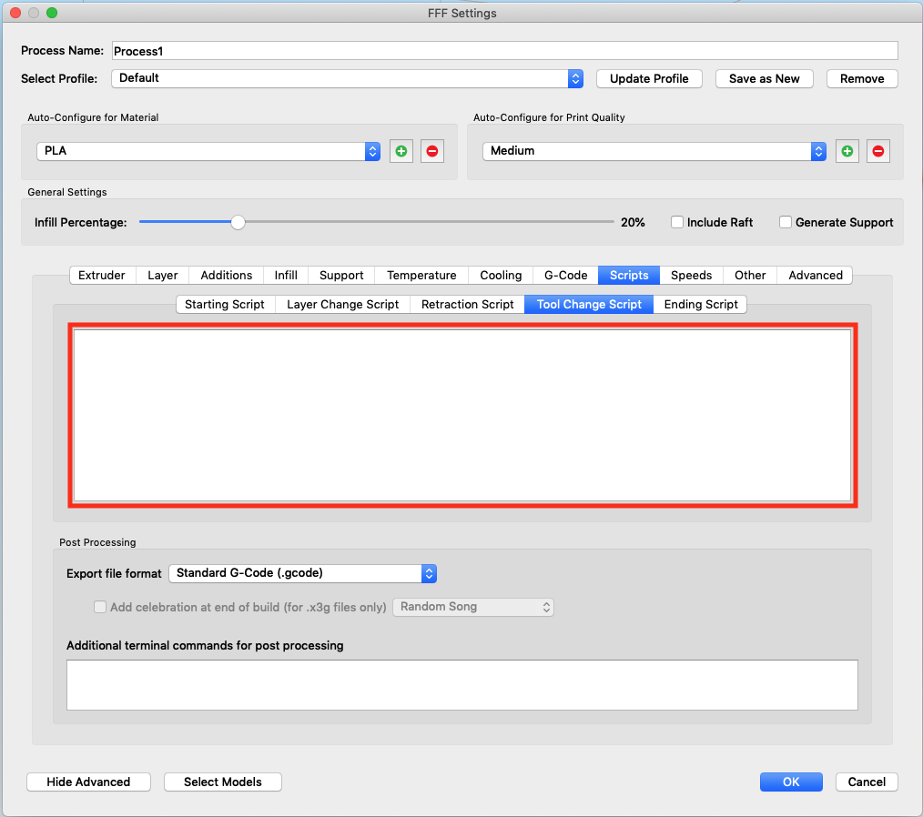

Bringing it back.
I'm having the same issue as the op. I see scripts that are supposed to fix this issue are posted here but I know next to nothing about s3d. Where do I incorporate these scripts? Are they copied into process settings under Scripts? Starting, Retraction, Tool Change?
Re: Dual Extrusion - First Retraction
These suggestions would be inserted into the Tool Change Script box in the scripts tab.
viewtopic.php?t=1959
I was leading you to water. The other users in this thread gave you the fishing pole, line, lures, etc..

To pay it forward, this script was sent to me from S3D support and it appears to work for me. As per S3D-Jake's instructions drop this in Scripts > Tool Change Script as is:
G92 E0 ; zero extruded length
G1 E-[toolchange_retract_distance] F[toolchange_retract_speed] ; toolchange retract
T[new_tool] ; perform toolchange
G1 E[toolchange_prime_distance] F[toolchange_retract_speed] ; toolchange prime
It will fill in the appropriate variables based on the tool being changed to. You should then set up the Tool Change retraction settings in the Other tab as you want them.
