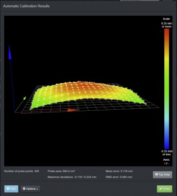

Is the glass warped, or is the gantry sagging? On my old Makergear M2, the plate with the linear rail for the X axis would take on a little warp. Some said it was a reaction to the belt tension - I never confirmed the true cause. I removed the linear rail and put shims under it to flatten it out.
On my current printers - Raise3D N2/N2+, the gantry is supported by 8mm linear shafts. The length of the shafts and the weight of the print head result is an slight sag in the gantry. Many users make the same claim that you are - that the bed is high in the center. The reality is that the gantry is low in the center.
On my machine, I confirmed this by placing a 3/4" piece of MIC-6 aluminum on the print bed after upgrading the control board and adding a BL-Touch probe. The sag in the gantry resulted in a bed map that looks like this:

zemlin wrote: Sun Sep 20, 2020 10:54 am Is the glass warped, or is the gantry sagging?
<snip>
You're right. I know exactly that from one of my replicator clones. But on his printer the x axis is running on a 20x20 profile and not
using a (heavy) direct drive extruder. Sagging there would be quite worrying... ^^
Somehow I assumed he's been checking this using a metal straight edge ruler after he's been watching quite some videos regarding this,
thanks for pointing out other obvious points.
