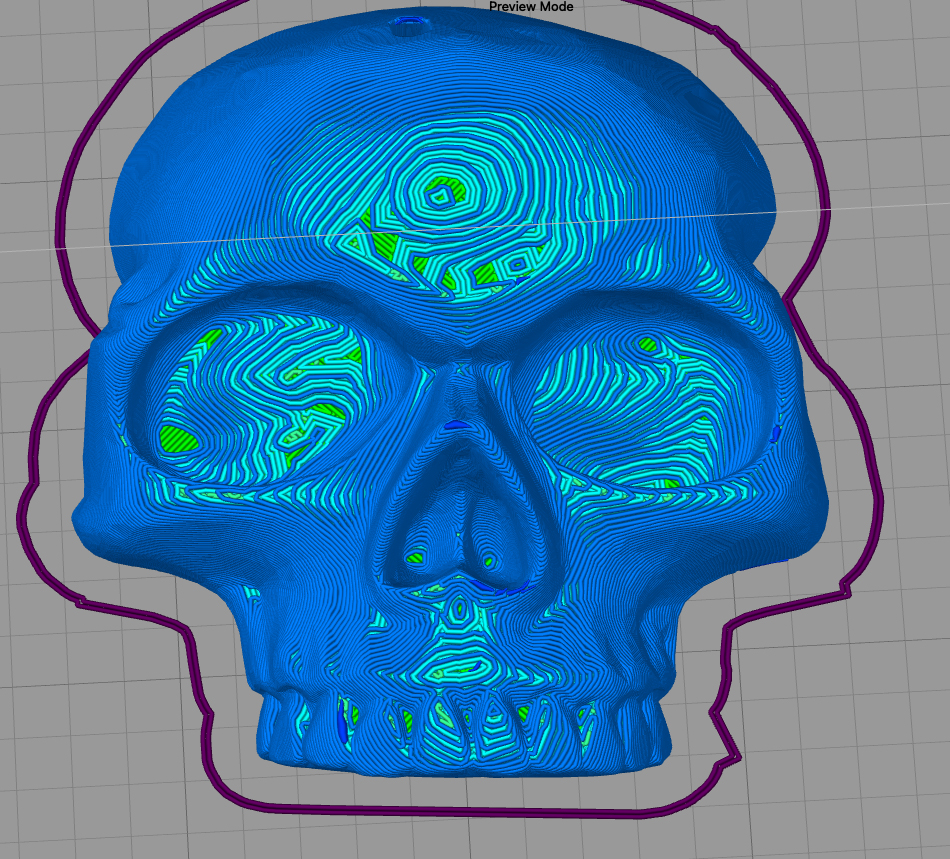

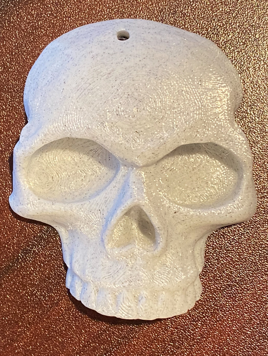

Hello, I'm having a problem with my top layers not being printed perfect. The blue lines on top seem far apart from each other (Seen in Picture 1), When printed you can see the teeth, top forehead and eye top layers are not being fill in all the way. But the rest of the print is amazing.
Please help, Thank you,
Mac

Re: Top layer quality problem
Thank you for your help!!!!! I see that I have to lower my layer height. Sorry new to 3d printing!
