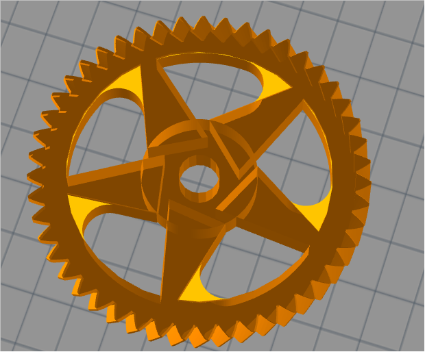

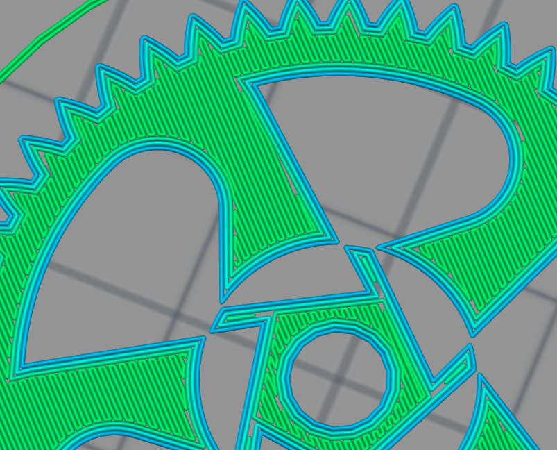

Slicing:
- if the STL-file have inside triangle areas (not complete or right merged objects), slicer have a problem. This object is not printable with S3D.
see the attached file
I found a lot of files with the same problem.
