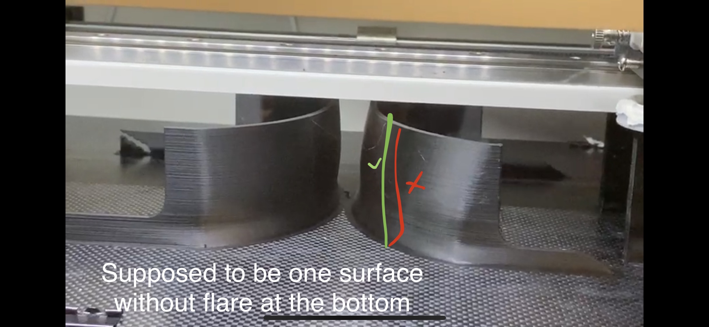

Printing with verbatim black pla. 1.75
I actually have pretty good bed adhesion, I do get some small corners lifting.. my main concern is that the part still warps badly above the first layer!
This is super annoying and has destroyed some large prints.
Heated bed is at 60
Cooling fan layer 1 at 0%
Layer 2 100%
This shrunk like hell so I tried applying more gradual cooling,
Layer 1 0%
3: 20%
5: 40%
7: 60%
9: 80%
11: 100%
Extruder 210* first layer
200* after that..
Any ideas?
Thank you!
