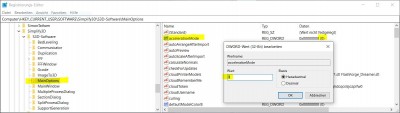

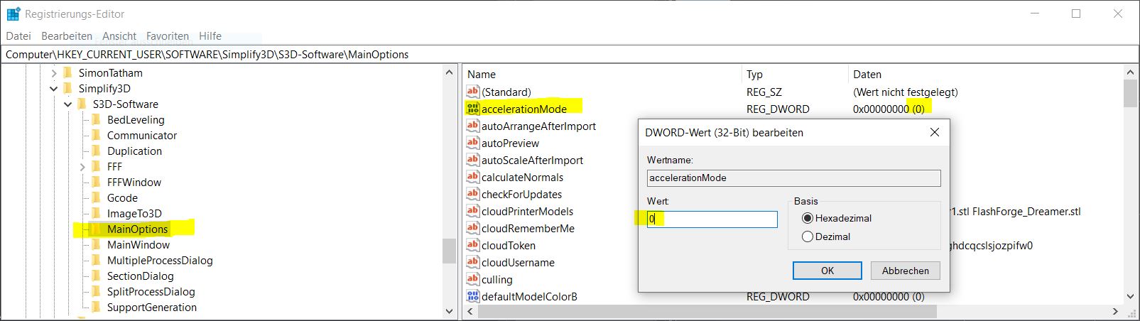

I found this in a suggested link before... but where do I put these values? Are they the ones in the parenthesis?

feste wrote: Sat Oct 31, 2020 5:47 am 0 - Automatic
1 - Native
2 - Compatiblity Mode
3 - Disable
That's the values for "accelerationMode" inside the registry, right here:

feste wrote: Sat Oct 31, 2020 8:38 am I have seen that the change in the register is not very complicated - but I do not know what the consequences are. A double click and asks me if from 0 I can change values. Ok... but I've never done these things and I don't know what the consequences are. What Parallyze told me now seems to me the only possible option, but why do I have to make an extra save and if I change 0 with 1, 2 or 3? Is it so devastating and dangerous? I don't want to mess with the operating system and then find irreversible damage.
1. The accelerationMode does have different options. Entering 0 would be like selecting "automatic" inside S3D. "1" like selecting "Native" and so on.
S3D stores settings/preferences inside the registry. That's what the "S3D-Software" hive is for. The reason you should export this before making changes is so you have a backup. S3D does store lots of other information in there (window positions, colors, units, process settings and so on)...
