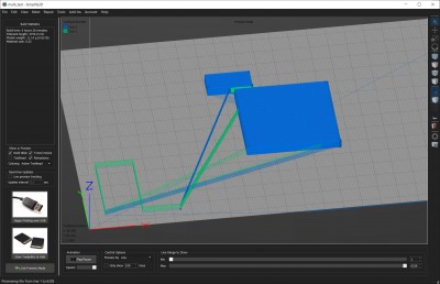

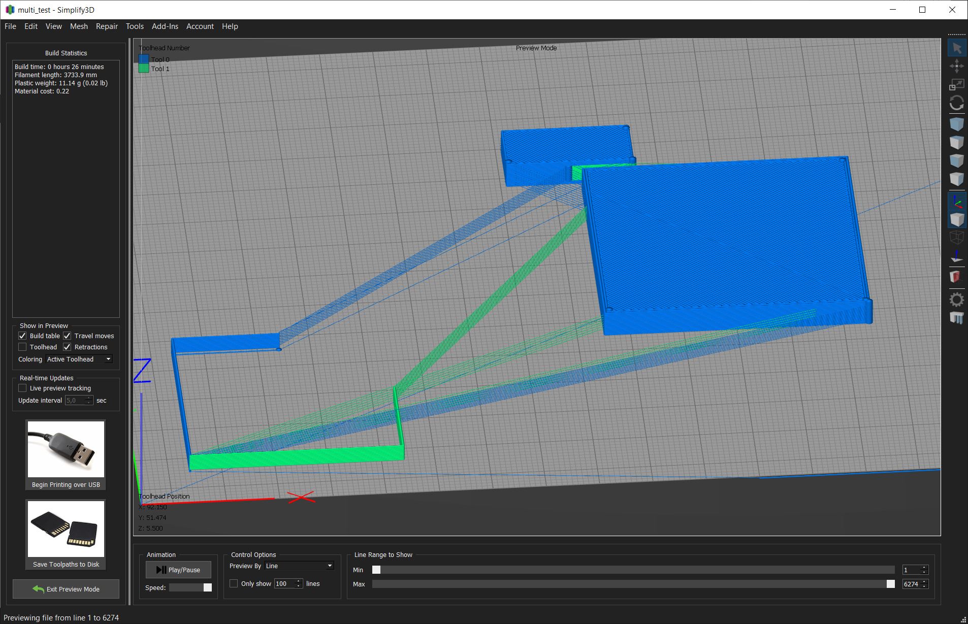

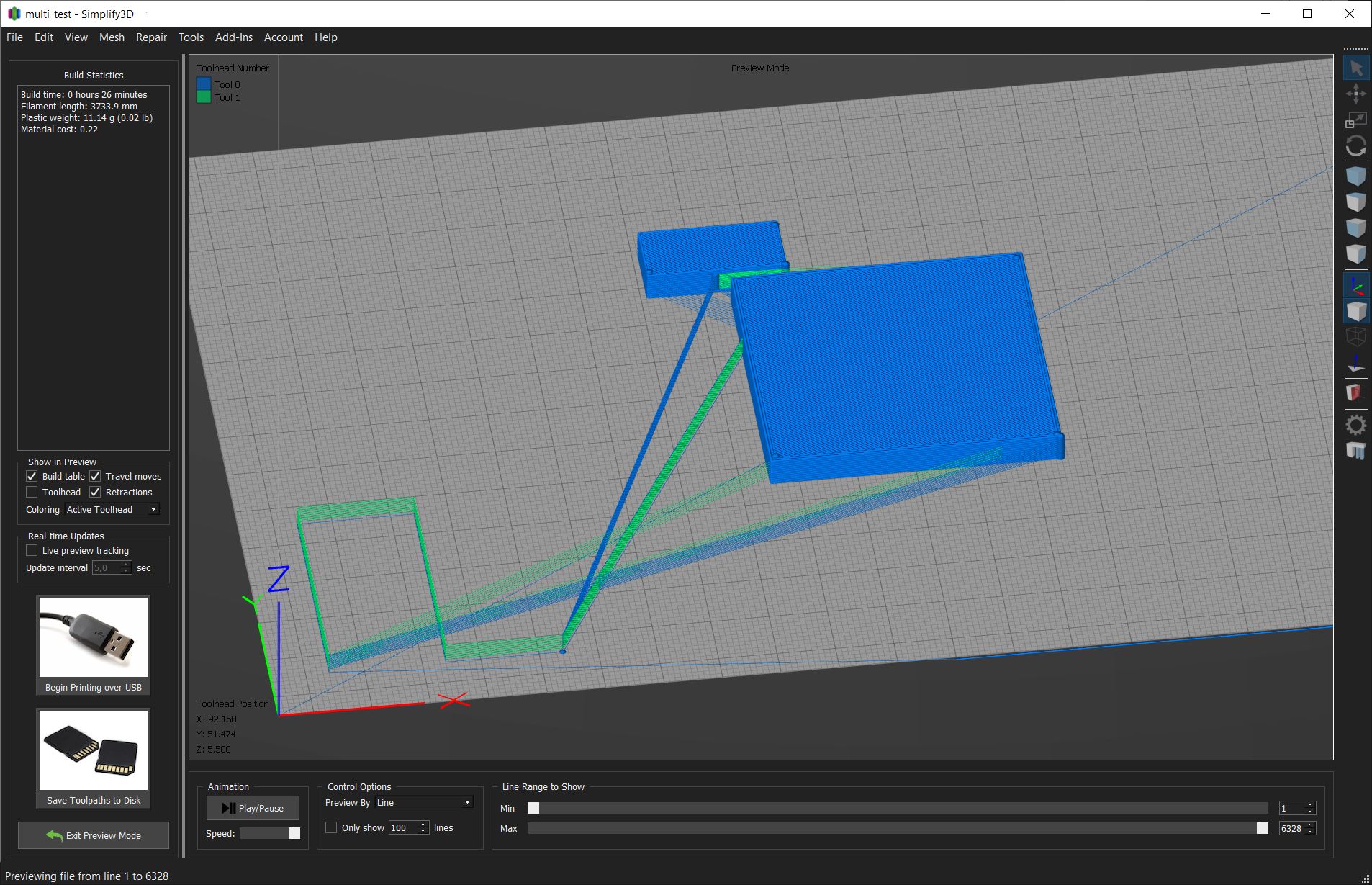

This will make the toolhead travel to X10/Y10, change the tool and do two small extrusion moves
depending on what the new tool is (blue T0, green T1):
The IF NEWTOOL statements are optional, just adding movement commands there will apply to
each change, no matter what tool is selected.
