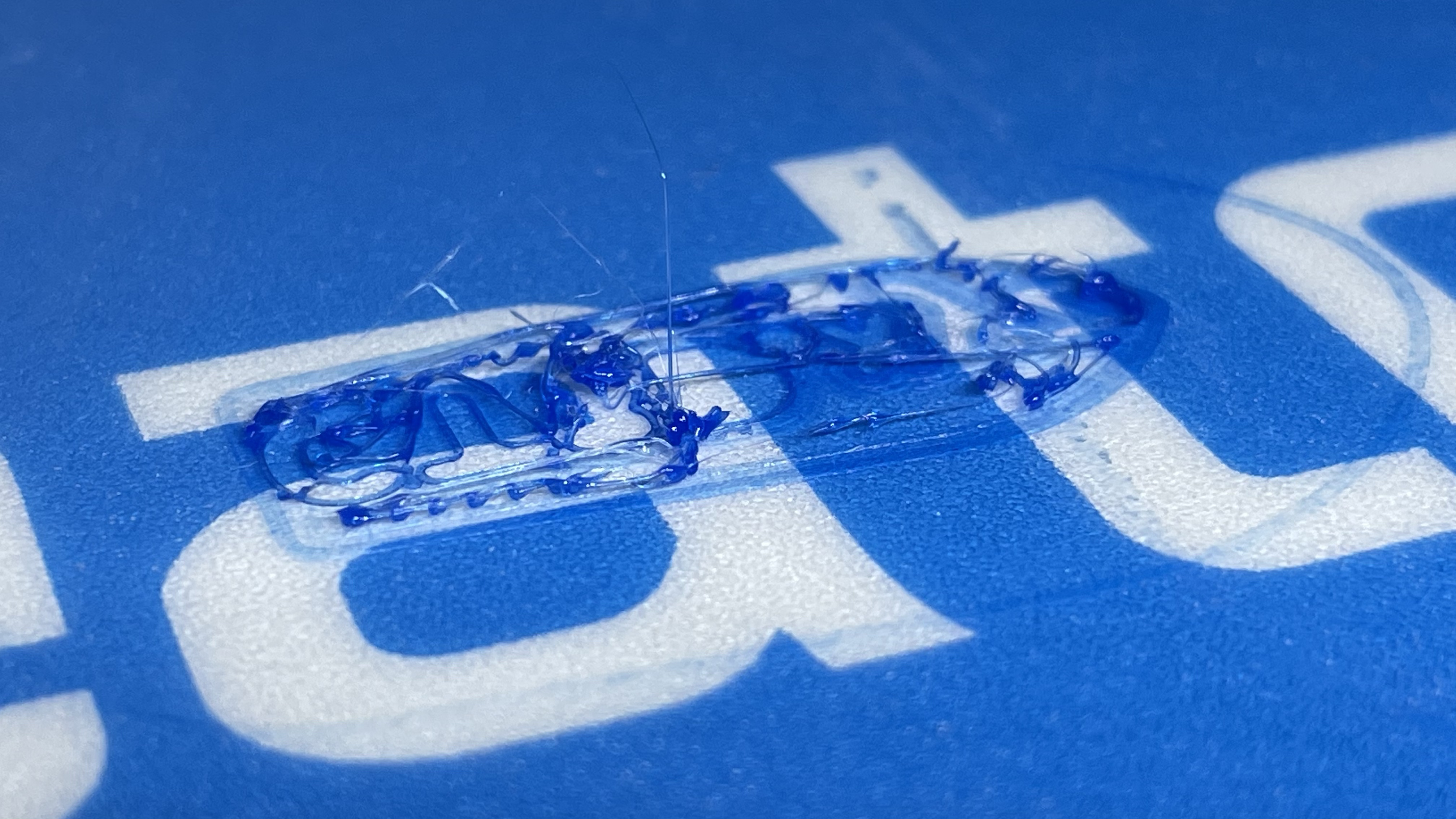

First time posting here. Tried troubleshooting my issue for several days but I can't seem to get it just right.
I've got a FF Creator 3 that I'm using with S3D. Whenever I try to begin a print, the outer perimeter and skirt usually go down slightly too close to the bed from what I'd prefer, but not the end of the world. However, the infill itself is way too far away to even adhere to the bed. I've tried countless bed level calibrations, changing the extrusion width, speed, layer height, layer width, moving them up and down and nothing seems to work as I continue experimenting with it. This also continues as the print progresses upward and the model itself begins to split. I'm not entirely sure if this is an issue with S3D or the machine not interpreting the g-code correctly, but I'm almost at the end of my rope.
I also have a FF Creator Pro and I've never experienced said issues on there so I really don't know what it could be.
I have included an image from the latest failed attempt. This is of a 3DBenchy. The skirt and the outer perimeter are a bit too close, but the infill (those blobs) is way too far. This is all part of the exact same layer.
Any input would be much appreciated! :)
