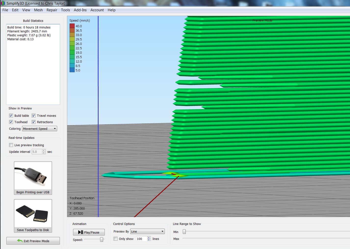

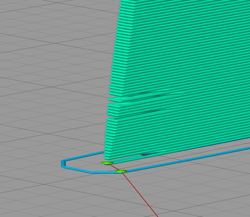

I am getting an error manifested when I try to print this file. I have printed this file hundreds of times no issues. I tries reexporting the file and I also tried netfabb to "fix" it but nothing seems to work.
Its a simple vase mode print but its glitches on 4 layers and I can't figure out why. image and factory file attached.

so its likely the slicer doing it? I tried reexporting it no change. and I ran it through netfab. no change.

No joy this is the fixed stl sliced.

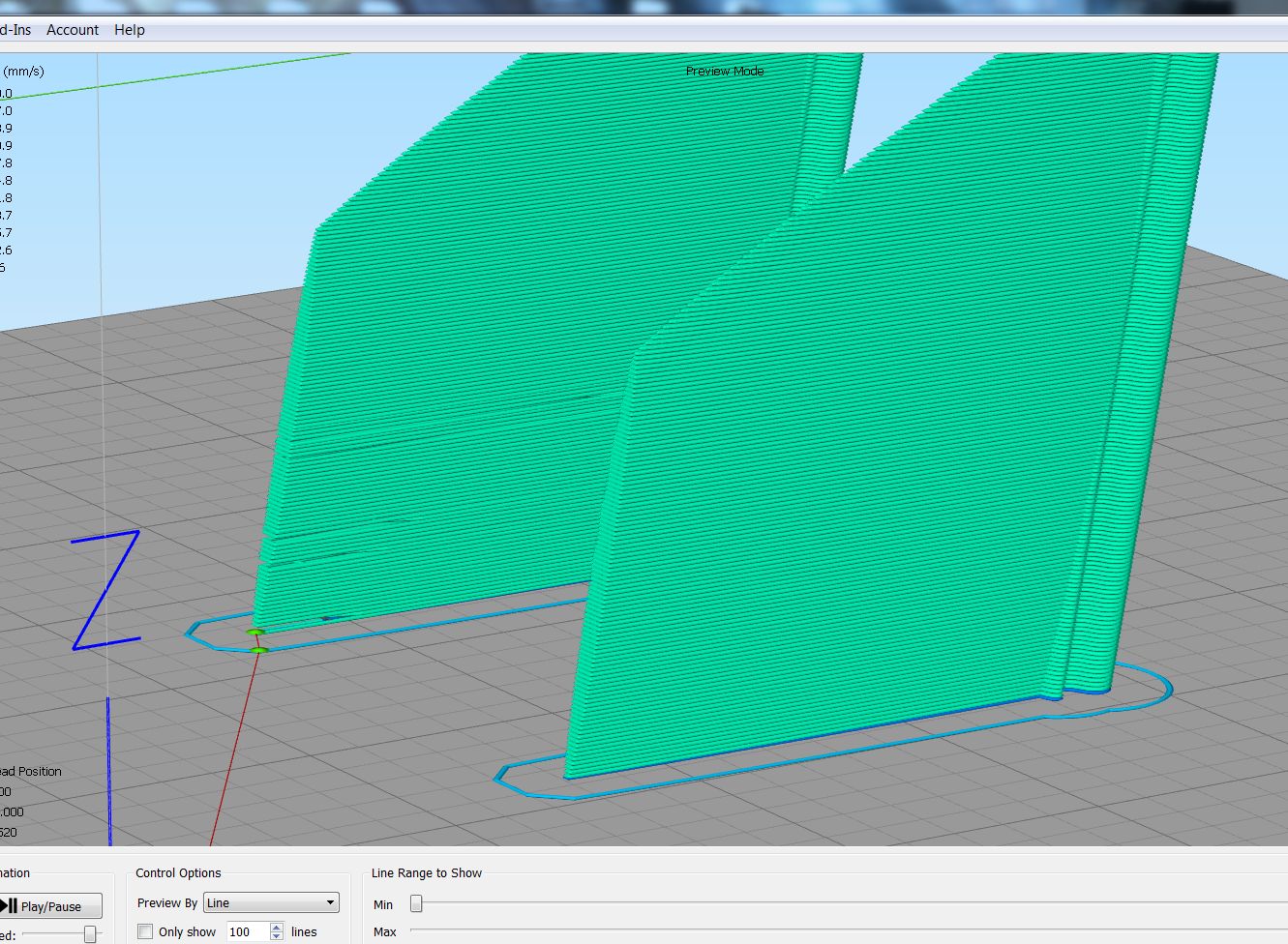

The artifacts go away completely. normal print. but alas I can't do that and retain vase mode (these parts are specifically designed for vase mode printing) and if I sequential print the artifacts come back.
NOW this is odd. when I sliced 9 the artifact was in all 9 but when I slice "JUST TWO" the artifacts are only in one. this makes it pretty clear this is a slicer bug. its literally a copy past of the same file !!!
if I then DELETE that rear artifacted file and only slice the "good" file. its broken again.
SO I went back to two files sequential printing a process for EACH copy. copy 1 has artifacts and copy 2 again has NO artifacts perfect print
if I then reslice but only select process 2 that had no artifacts. it now has artifacts. This seems to be clearly a slicer bug. problem is it was working FINE yesterday. I did not change the files and reexporting the file does not fix it and netfabb finds no issues.
ALSO if I reverse the processes print 2 first then 1 it flips. now the front one has artifacts and the rear one does not.
