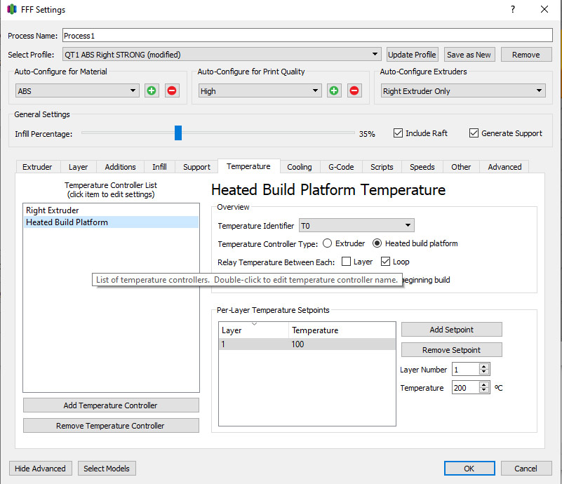

Hello, I'm having trouble getting my buildplate to heat. I have a working gcode file that does heat, but all my new files made with Simplify3D do not heat the plate.
My scripts:
T0; always home on the right extruder
M73 P0 ; Enable build progress
G162 X Y F3000 ; Home XY maximum
G161 Z F1200 ; Home Z minimum
G92 X0 Y0 Z-5 A0 B0 ; Set Z to -5
G1 Z0 ; Move Z to 0
G161 Z F100 ; Home Z slowly
M132 X Y Z ; Recall home offsets
G1 X-95 Y-70 Z30 F8000 ; Move to wait position off table
M126 S[fan_speed_pwm] ; Set fan speed
M140 S[bed0_temperature] T0 ; Heat buildplate
M104 S[extruder0_temperature] T0 ; Heat right extruder
M116 ; Wait for all temps to be reached
G130 X118 Y118 Z40 A118 B118 ; Default stepper Vrefs
G92 A0 B0 ; Zero extruders
G1 X100 Y-70 F9000 ; Move to front right corner of bed
G1 Z0.3 F6000 ; Move down to purge
G1 X-90 Y-70 E24 F2000 ; Extrude a line of filament across the front edge of the bed
G1 X-100 Y-70 F180 ; Wait for ooze
G1 X-110 Y-70 F5000 ; Fast wipe
G1 Z0.5 F100 ; Lift
G92 A0 B0
M73 P1 ; @body (notify GPX body has started)
I've tried to copy the same scripts from the working Gcode over but that didn't seem to work.

Thank you for your reply. I had a duplicate post that had that information but wasn't approved. Here is the code in the file that I use to make a temperature tower to decide on proper temperatures. This one heats the bed to 60 degrees and stays 60.

If the second code you posted is working then it seems like this is an X3G machine. What printer are you using currently? I am personally not aware of a QT1. The M134 used for the bed heating here seems to be the main difference between the two.

Thank you again for your help. After looking into it further I was using a profile that wasn't suitable for the printer. After running the setup wizard I was able to find the right profile and now the bed heats up and the prints look fabulous. Case closed!
