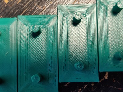

While struggling with other issues I noticed that printing this stringing test piece with 100% fill and 9 outlines, the top layer has a lot of gaps, like it would be under extruding. While monitoring the print the inner layers however have no issues at all and the shells fuse together nicely.
Extruder steps are spot on so it's not that and that's why I wouldn't want to go around the problem by just increasing the extrusion multiplier.
Could this be because of the thin wall settings?
Left most print in pic with several pieces is sliced with Cura, others with S3D.
Nozzle & extrusion width 0.6
Layer height 0.2
Infill 100%
Solid top and bottom layers 4
Outline shells 9
(Full profile attached)
Tronxy X5S - PLA - gaps.zip
(2.99 KiB) Downloaded 100 times

Was the cura part printed with the same size nozzle? The perimeters don't span nearly the same width.

zemlin wrote: Was the cura part printed with the same size nozzle? The perimeters don't span nearly the same width.
Yes, same exact setup but Cura line width was different in that pic. This was accidental comparison anyway as I was troubleshooting other Marlin & S3D related issues so it was a bit poor comparison pic in that way but just verified and Cura does almost perfect job with the same 0.6 mm width as with S3D. There are some gaps between inner most perimeter and infill but that's due to other setting issues. The perimeters themselves are fused together.

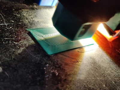

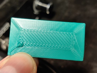

Here's a better pic of a 3rd layer. Again, same speeds apply here. I have bed heating off so it shouldn't be about temperature differences either.
Maybe it is something about in this materials properties that causes the shells to break apart once enough layers are stacked, dunno, but as for the lines getting thinner on straights I guess it's just the bowden setup pressure not keeping up with fast speeds. Marlin linear advance would maybe help a bit but can't use that due to my TMC drivers being incompatible ones.
Would be anyway neat to get more pressure compensation features in S3D too. Or get any new features really...
