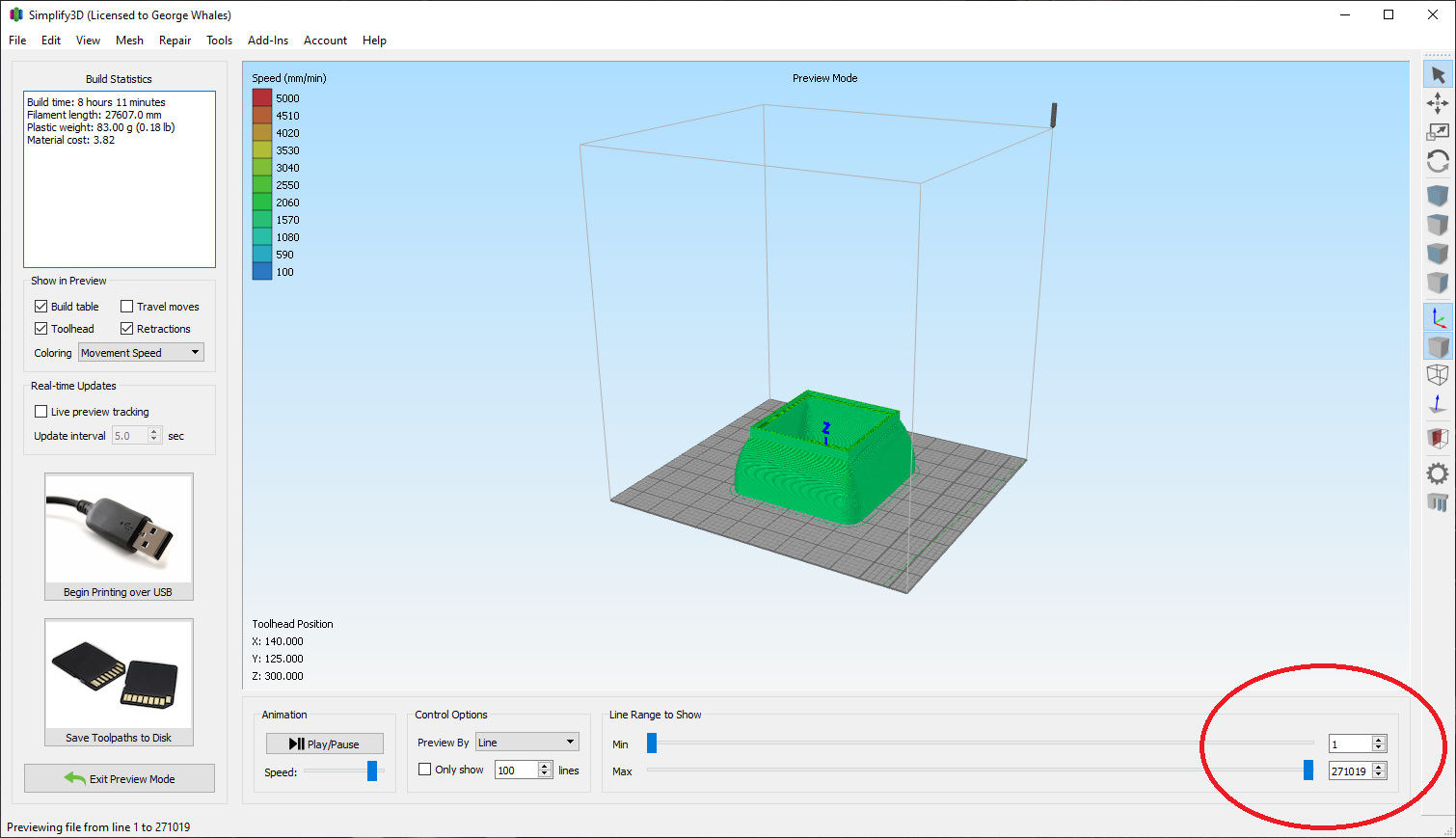

Hi All,
The layer counter in preview is showing a crazy high layer count - 271,019. I didn't know there could be a print with 271thousand layers.
Any ideas on how to fix this, I tried un-install/re-install which didn't help
Thanks

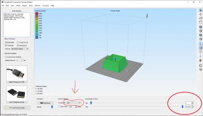

NuGeo wrote: Sat Mar 20, 2021 9:50 am Any ideas on how to fix this, I tried un-install/re-install which didn't help
Switch back to layer view, that's line view (line # inside the gcode file being previewed)...

This can happen when previewing a gcode file which wasn't created using S3D. It switches to line view then and keeps
this setting until you switch back to layer view manually... ;)
