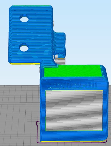

I asked Simplify3D to produce the gcode for the model joined, with support from anywhere.
Unfortunately, it seems that Simplify3D failed while generating support for one big part of the model, as shown on the picture under.

We're going to need your factory file to be able to debug what's going on. There may be an issue with your shape file, it may be an issue with the auto-support generation, it may be .........get my point?
File dropdown....Save Factory File.

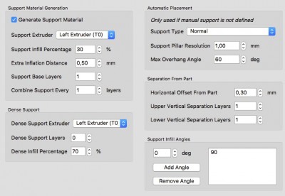

Re: Bug while generating support
No way is this a bug. It is 100% the settings used!!!
Try changing the Max Overhang Angle in the Support tab...
45 will give some support under the angles
40 will max out the support for the shape.

[SOLVED] Bug while generating support
thanks
it solves the problem.
