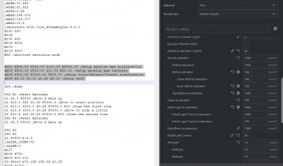

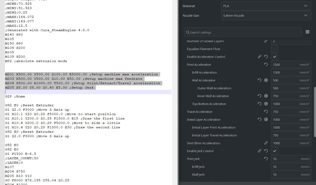

Just a guess, but:
Maybe Cura is set up for this printer profile to apply acceleration/jerk values (Speed settings). S3D doesn't offer this, so maybe you'd like
to create a gcode file in Cura and copy the settings for acceleration/jerk from there to your S3D start script.
Or, if possible, write those values to the eeprom of the printer to make them permanent.

Thanks so much for replying i appreciate it.
That's a fantastic idea i didn't know i could do that :)
i will give it a go as soon as i get time on the printer.
