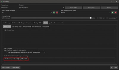

You can include this as mentioned inside S3D so it will run automatically for each gcode file you export using that profile:
