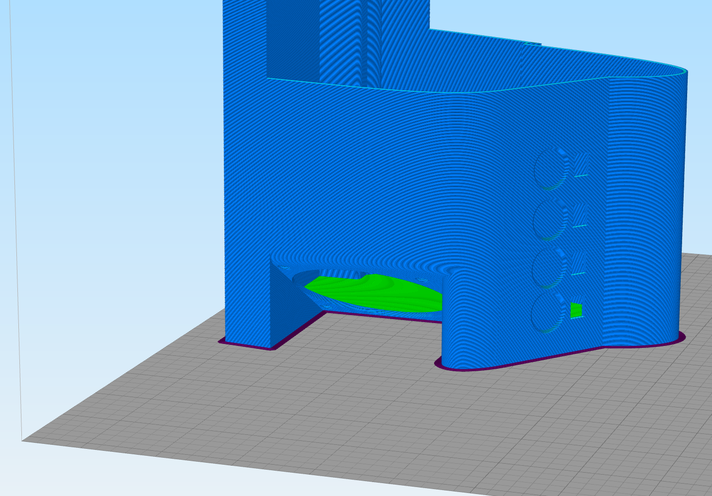

How to print a brim that skirts the part and not he supports
I have a part with a small footprint but very tall for it's width. All the way around this is supports. It is hollow on the underside/inside except supports. I don't want to use a raft as it was a bit difficult to remove. How do I print a brim that goes around the pieces edge not just around all the support edges. Cura will print the brim like this with the supports printed on top of the brim.

I agree, that's a problem. In the part below there's a brim all the way around. But if I enable support for the sloping cave like area in the photo then the brim won't go into the cave at all. Printing in ABS that is a real issue. So I have to create brim features in CAD which is a pain.

Re: How to print a brim that skirts the part and not he supports
maker2 wrote: Fri May 14, 2021 3:43 pm ...But it would be a whole lot easier if S3d just printed support over Brims.
You can enable support base layers in the Supports tab. This will add a Brim-like bottom layer for all of your supports that make contact with the bed.
maker2
Posts: 142
What a great option! All this time and never noticed it.
Thanks a lot @S3d-Jake!!
