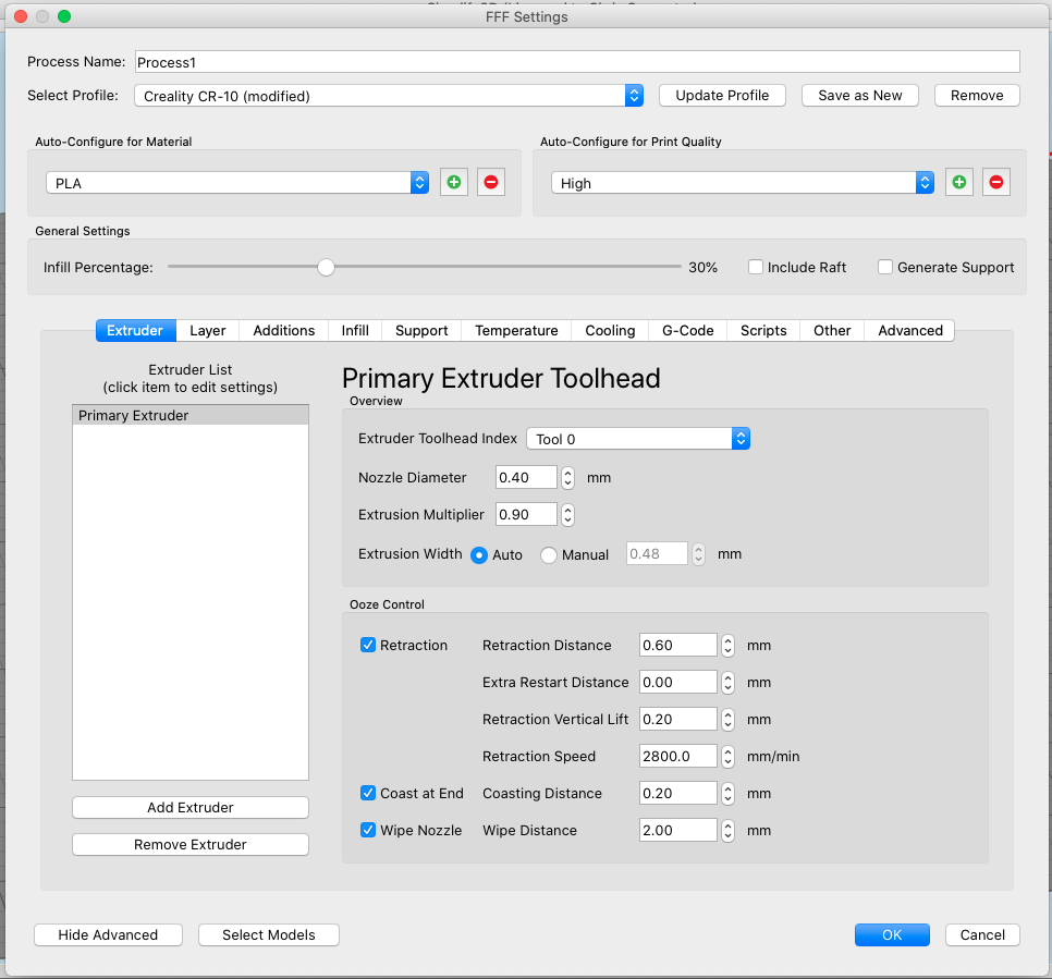

I have not been able to find a CR-10 V3 profile from Simplify 3D. I found one on Thingiverse and started with it. I modified the retraction setting to have:
Retraction Distance .6 mm
Retraction Speed 2800

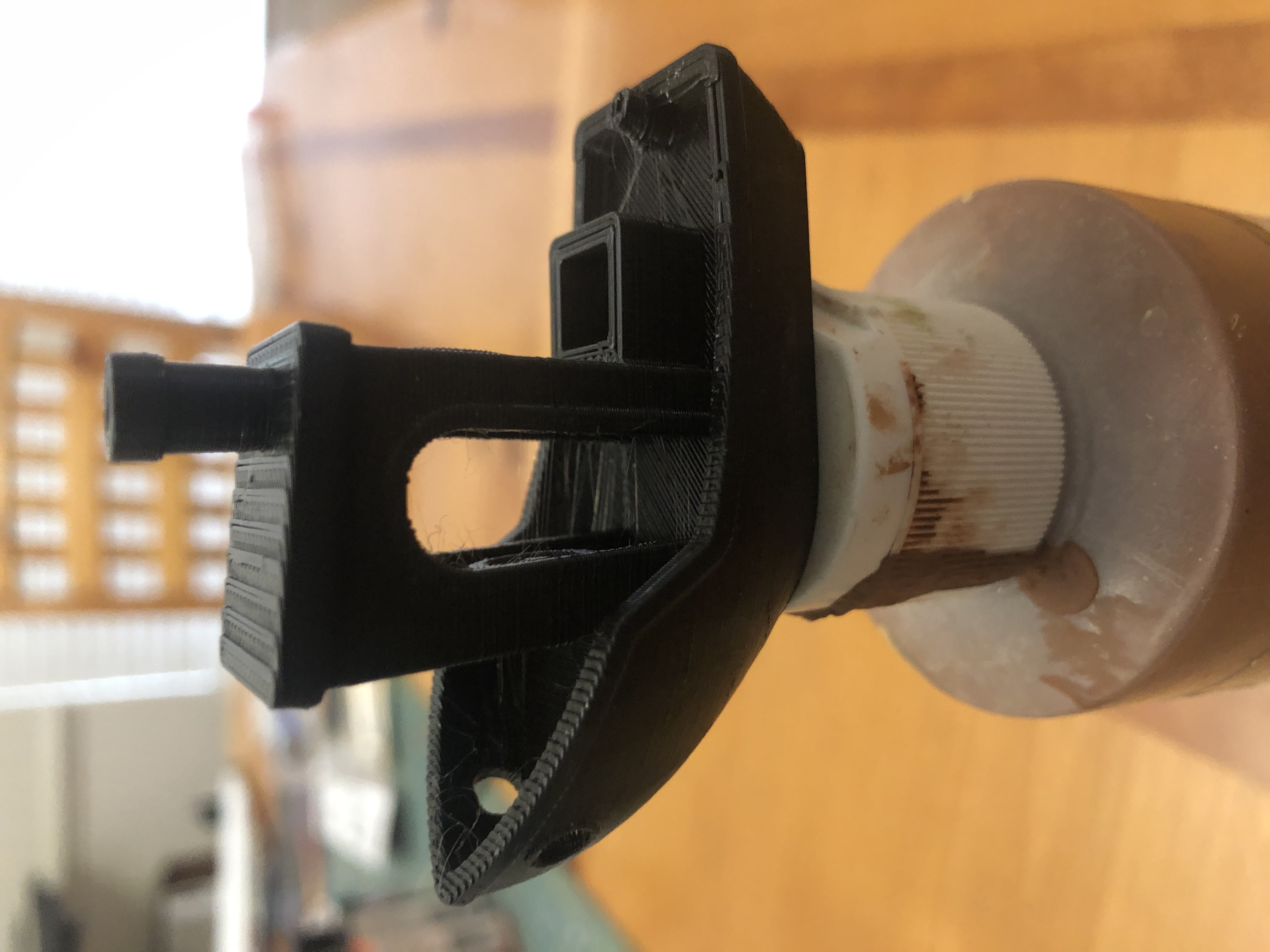

I attached a screenshot of the setting. I'm still getting some stringing. The prints look good though. I'm attaching a High quality and Medium quality Benchy photo. I"m just looking for some tips on how to remove the stringing.
The full profile is attached.
