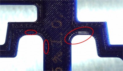

Basically, I'm getting gaps between inner perimeter passes. The defects are repeating layer upon layer, so you end up with a delamination between the perimeters. I've have experimented with a very wide range of settings for thin wall behavior in the Advanced tab, without any effect.
I'm running a 0.35 mm nozzle and a 0.40 mm extrusion width, using eSun PLA+ filament on a MakerGear M2E printer. I'm using S3D version 4.1.2.

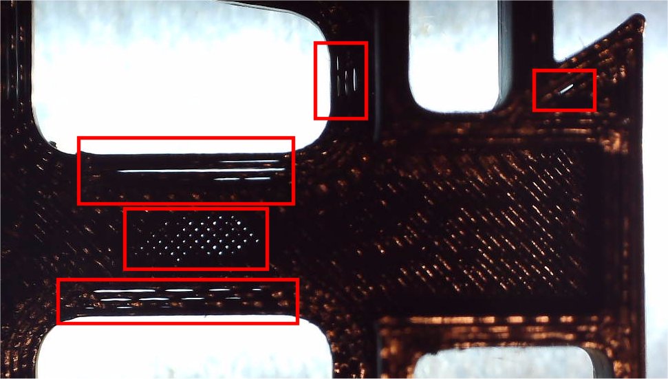

Here's a picture of a small chunk of a larger model that I've been using to test things:

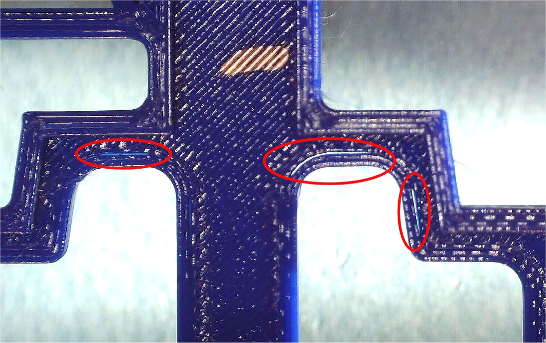

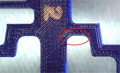

I've managed to improve things a bit since this. I changed to a new spool of filament, re-calibrated my extrusion multiplier, adjusted the temperature, etc. and that got me here:

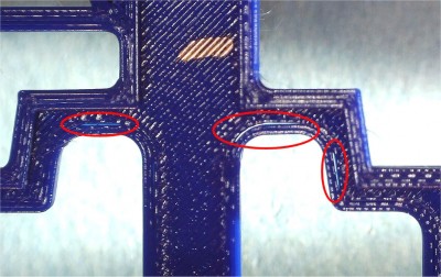

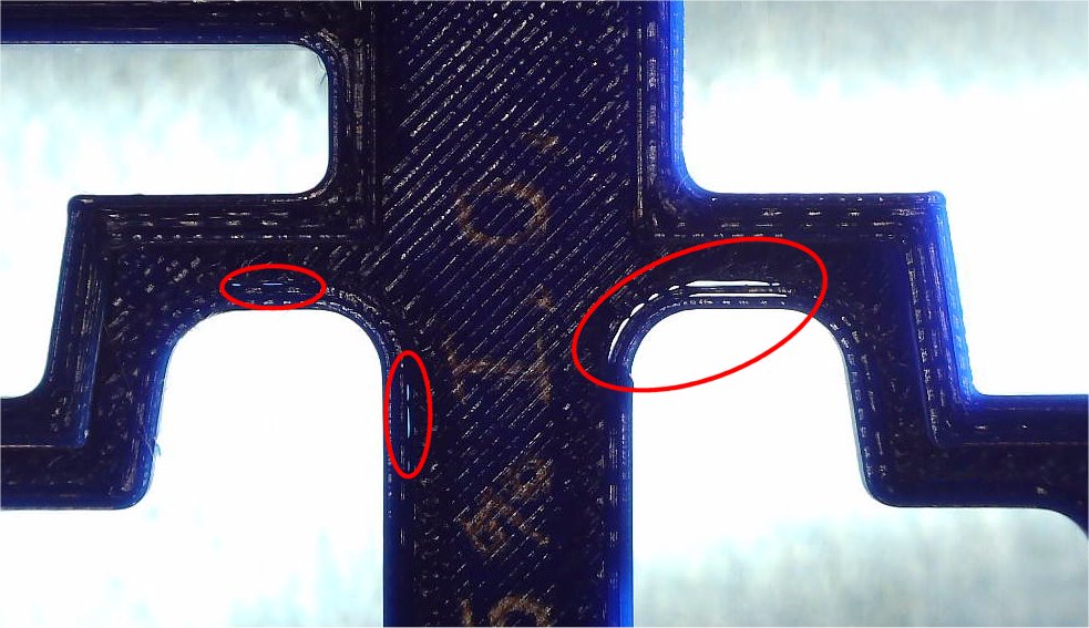

Still lots of gaps. I posted this with my factory file in the other thread, and the user "airscapes" was kind enough to take a look at it, and provided me with a modified version he felt should work better. He changed a number of thin wall setting in the Advanced tab, decreased the number of perimeters from 3 to 2, and changed the print order to inside-out. His settings produced the following results:
I still have gaps, pretty much just as bad and in the same locations. There are gaps that didn't show up well in this photo because I couldn't get the camera lined up exactly vertical over multiple areas so the backlighting would show through. I did notice that the gap appears between the last perimeter and the 2nd to last. In my 3-perimeter process, the gap is between pass 2 & 3. Airscape's process with 2 perimeters has the gap between 1 & 2.

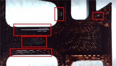

OK, test print is done. You can see where the infil is attempting to attach to the perimeter in a few places, but it's not really doing anything to close the gaps, especially between the perimeter passes:
I just started a 16 hour print job, so I have some time to ponder other options & suggestions before I try again..

Thanks for the suggestions. The third photo in my post above is using your factory file settings. It made no significant difference in the gaps.

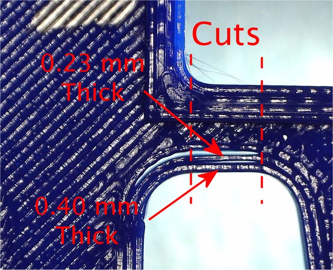

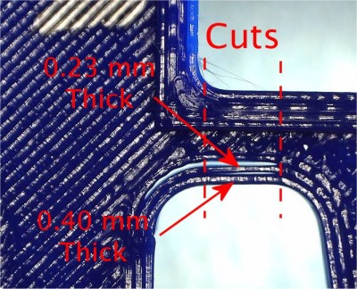

I cut up one of the recent test prints so I'm using the latest settings (temperature, retraction, speeds, etc.). I measured the thickness of two pieces of perimeter "wall" in one of the problem areas. The results show that the gaps are being caused by gross underextrusion. The inner most perimeter is 0.40 thick, and the next one is 0.23 mm thick.
Once you zoom in, you can see that the second pass is WAY thinner than the 1st one. I'm using 3 perimeters, and although it's hard to say for sure, it looks to me like the third pass is also skinnier than it should be.
I'm beginning to think there may be a subtle bug in the thin wall algorithms. It's acting like it is trying to print a thin fill pass when it shouldn't be. That might explain why someone reported this issue appearing with 4.1 after working OK in 4.0.
