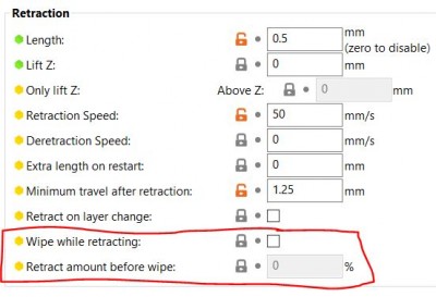

tenaja wrote: ↑Fri Jul 30, 2021 11:32 am Just be aware that Prusa slicer does not include coast or wipe
And be aware of roughly 50% of things said on the internet being wrong... ;)
(from PrusaSlicer 2.3.0)
Yes, it does work a bit different - but Slic3r/PrusaSlicer does have a wipe option.
tenaja wrote: ↑Fri Jul 30, 2021 11:32 am so it is only suitable for controllers with pressure advance.
On various direct drive machines using materials like PLA/PETG I've never missed coasting. This might be different for some
machine/material/bowden/extrusion width combinations.... but saying it's only suitable if something like pressure/linear advance
is used is wrong. Also you can't really compare them, coasting doesn't have any effect on extrusion except the small section before
retracting.
I do know a few people who disable LA when print times matter and they can live with the minor decrease in (corner) quality. But
none of them suddenly gets massive stringing or anything like that just because LA isn't used. Even on pretty cheap and CR-appy
machines.

I will take that correction, and give it a try again. In an instance like this, it's nice to be wrong...probably outdated info on my part.
I tried Prusa slicer over a year ago, and could not find coast or wipe, so I searched...IIRC, I found a forum thread where Prusa themselves said they would not add it because their controllers did not need it due to havingi pressure advance. Apparently, demand for the feature for other controllers superceded that.
These settings mostly comes in handy when you are trying to print fast. At slower speeds, it is not necessary.

@parallyze, I looked into it again, and Prusa Slicer still does not have coast. The screenshot you showed does not do the same thing. The request for it is being +1'd regularly:
https://github.com/prusa3d/PrusaSlicer/issues/246
(In that link, somebody shows a screengrab of the same setting you posted, and it is followed up with an explanation of how it is not coast. That setting does not stop e moves before the travel is completed--but that is what coast does.)

tenaja wrote: ↑Sun Aug 01, 2021 9:34 am @parallyze, I looked into it again, and Prusa Slicer still does not have coast.
And I've never said that Wipe equals Coast... I do know the difference.
parallyze wrote: Yes, it does work a bit different - but Slic3r/PrusaSlicer does have a wipe option.
Could you point out where I supposedly said Slic3r/PS do offer coasting?!
I'm not using PS or Slic3r very often. But Wipe was included in Slic3r years ago, although working a bit different than
in the current release of PS (there was no option to retract before the wipe movement, only "wipe while retract").
Maybe this was a bit misleading:
parallyze wrote: Also you can't really compare them, coasting doesn't have any effect on extrusion except the small section before
retracting.
I was talking about LA vs Coasting there, not Wipe vs. Coasting.
If you really want to go faster coasting won't be the ultimate solution. Just trying to save the retracts from getting a
mess doesn't give the beneftis of pa/la in corners/at angles. So if you really want to go faster - get support for pa/la.

I just wanted to correct your wrong statement(s):
tenaja wrote: Just be aware that Prusa slicer does not include coast or wipe, so it is only suitable for controllers with pressure advance.
Which are simply wrong. Slic3r/PS does have a wipe option. And you can use PS very well on machines without PA/LA. If
I didn't miss it the OP didn't tell us about his printer(s)... so missing coasting might be completely irrelevant to him.
