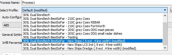

Additional Information - earlier today i exported the two profiles to my desktop. it seems that these warnings and errors started after that.
attached is a screen shot of my profile drop-down list.

it appears choosing this profile gives me the error. but i also notice now that the "default" profile has "modified" after it. hm.
and to clarify what i'm doing here, i'm simply selecting the drop-down list and selecting different profiles. thx.
(see attachment)
