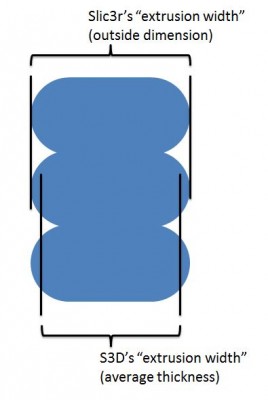

Now let's have a look at one picture from the above thread again:
So the extruded plastic has to be wider than what's defined as extrusion width in s3d. Otherwise the
strands wouldn't bond together, leaving empty spaces. And this extra material will slightly overlap the
objects boundaries on the outermost perimeters.
An extrusion width of 0.5mm in Slic3r will result in this:

Just as in S3D the outermost perimeters will be spaced 49.5mm from each other. But to get the
proper amount of overlap the inner perimeter is only spaced 0.446mm from the outer one,
not 0.50mm as in s3d.
By decreasing the extrusion multiplier here in s3d one would simply thin out the strands of plastic until
their real width is barely 0.50mm, resulting in accurate outer dimensions of the object but almost completely
missing the required overlap to fill the gaps between the perimeters/strands spaced at 0.50mm. So if the real
width of the extruded plastic was 0.53mm (adding +0.03mm to the 0.50mm extrusion width) you'd end
up with outer perimeters "protruding" about 0.015mm, making the 50mm cube ~50.03mm when printed.
You want to inset the outer perimeters to compensate for this, not lower the extrusion mutliplier.
