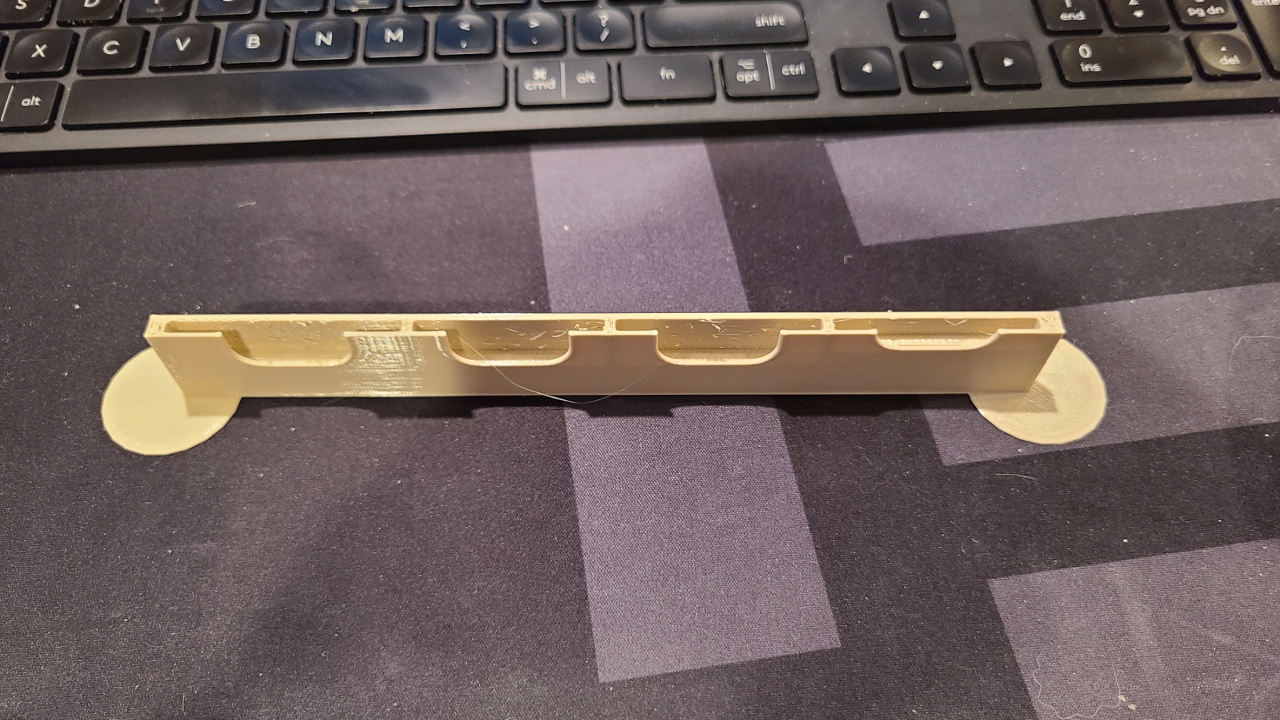

I've got a design that has one section where the walls are pretty tight and there is a fair amount of small movements. The rest of the model is very open. Basically, it is a box with one side where there are slots designed into the side. See below.
The issue is that when printing the side with the slots, the print shows tons of blobs and potentially vibrations that mess up the print, just for the time the slots are being printed. below and above the slots, everything prints fine.

To cut to the chase, here is one example of the issue. (I sliced up the Fusion 360 model to just print the wall with the slots and the issue shows up no problem)

For any future travelers who pass by this way, the issue was with print speed. had to slow down by half and things worked out well.
Given the size of the print, I'm working on conserving time by inserting a "slow" process for those layers as opposed to slow for the entire print.
