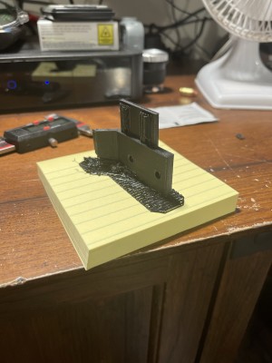

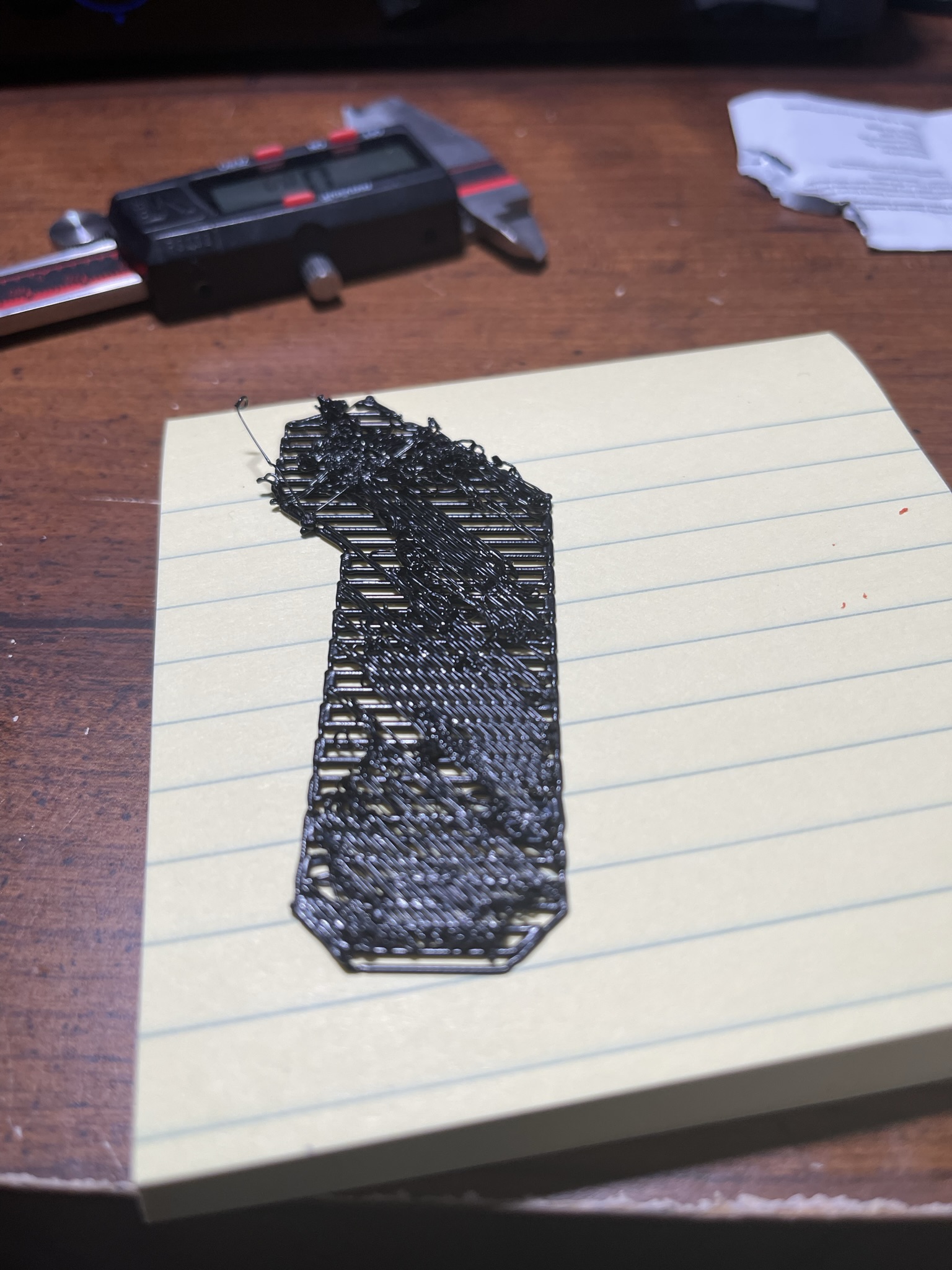

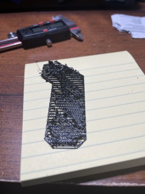

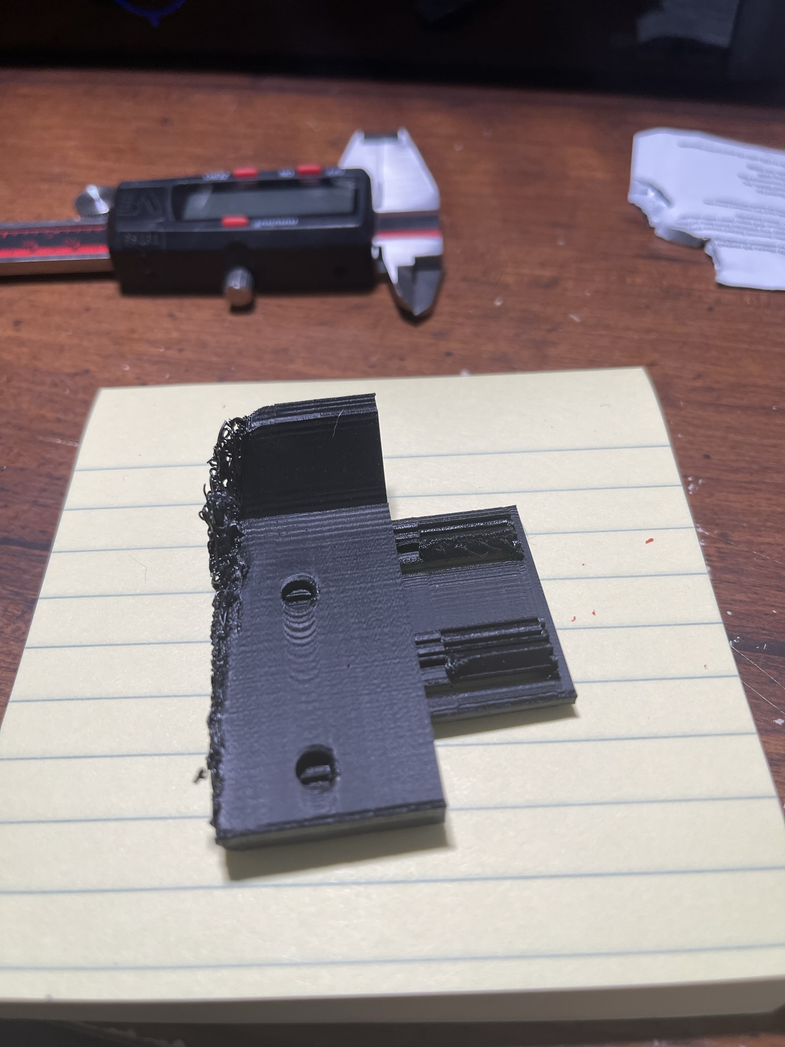

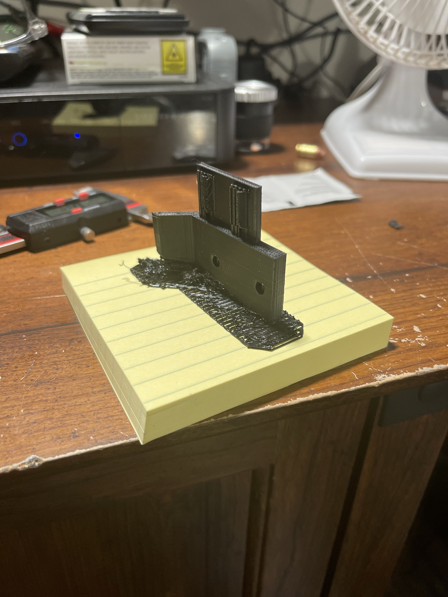

As a test, I let the job run to completion. But, unfortunately, what I found was an issue with the raft and only the raft.
The first layer of the raft laid down correctly. However, the second and subsequent layers of the raft are a mess. I suspect that the second and third layers of the raft are extruding too fast or too slow, I'm not sure which. However, once the job gets past the raft, it prints the job more or less correctly, except at the raft object interface.
If I can figure out how to print the raft correctly, the whole job will print correctly. The part is too small to stick to the plate without a raft.
I’m in the process of googling how to slow down all the raft layers, but while I’m doing that figured it wouldn’t hurt to post some pictures and a better description of what’s going on, with the hope that you guys can tell me where I go in simplify 3D settings to try and correct this issue.
I’m also going to conduct the test by printing a 40 mm x 40 mm x 2 mm box without a raft to see if it prints correctly. I’ll let you know how that works.
Any thoughts would be appreciated.
Thanks

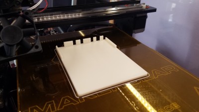

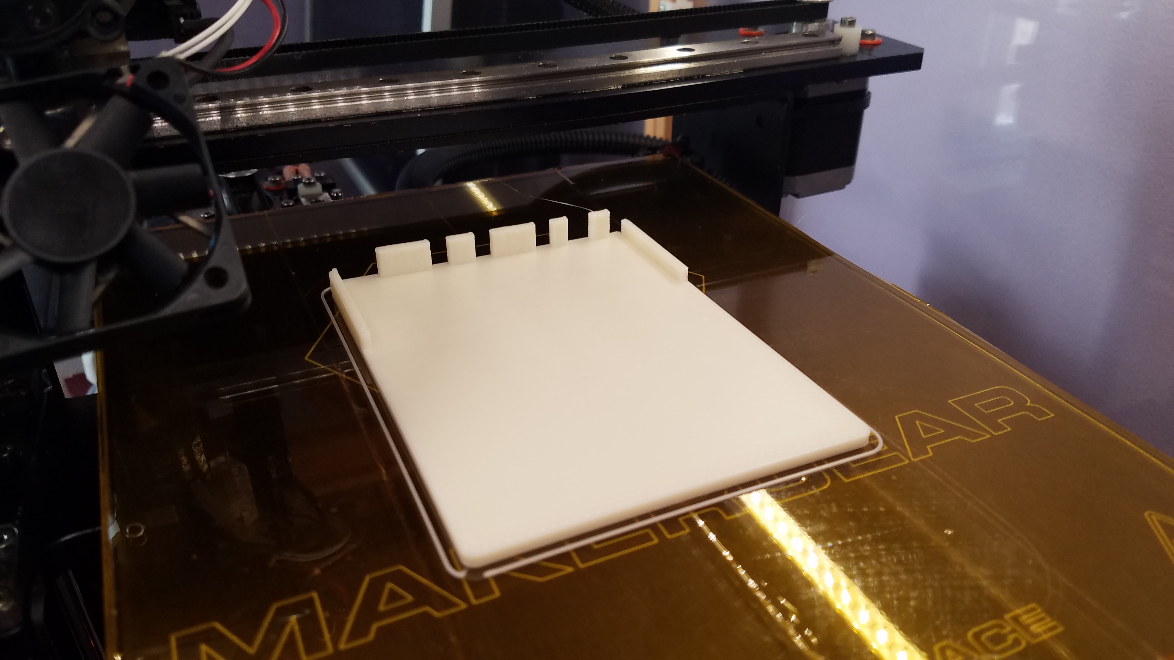

I am actually removing an abs print from the printer when I am done with this post

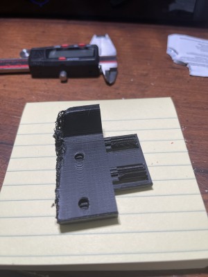

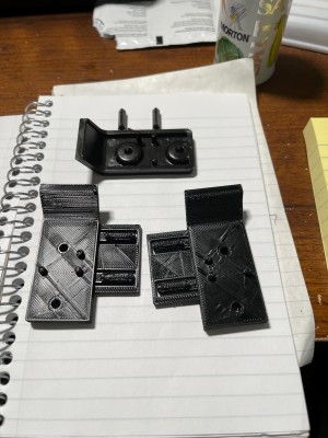

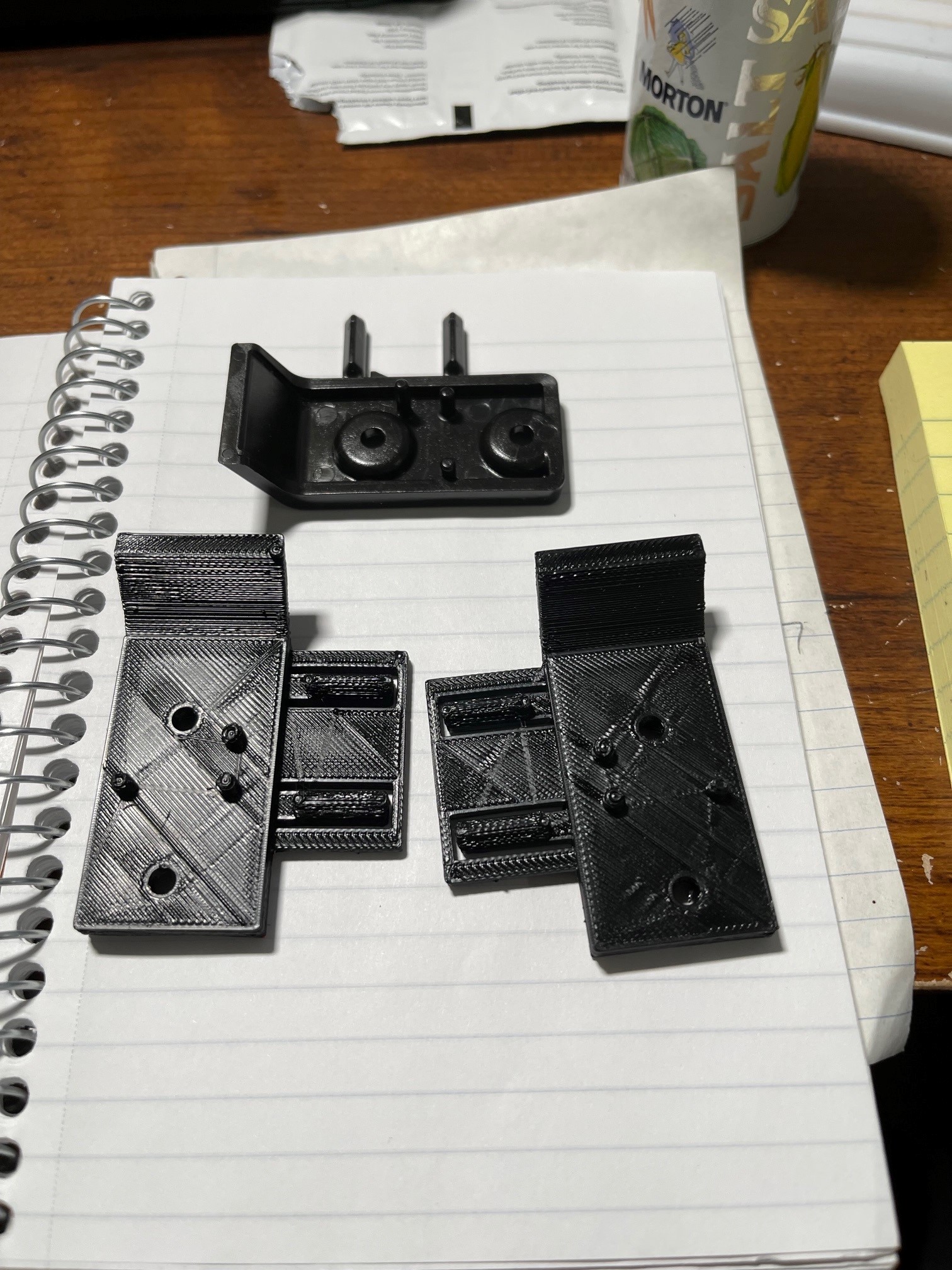

The parts printed OK on my A10T. Only mistake was failing to change the extruder for the brim to the left side spool, which was black ABS. It was set to the right, which was red PLA. Never the less, they printed.
The new parts are on the bottom, and the broken original right hand piece is above. I think I can tweak some settings to get a better quality finish, but not going to as these parts are hidden. They hold down the folding rear cargo lid on my 2021 Jeep Wrangler. If they turn out not to be strong enough, I'll send the file to someone on-line that can print them in fiber reenforced nylon.
