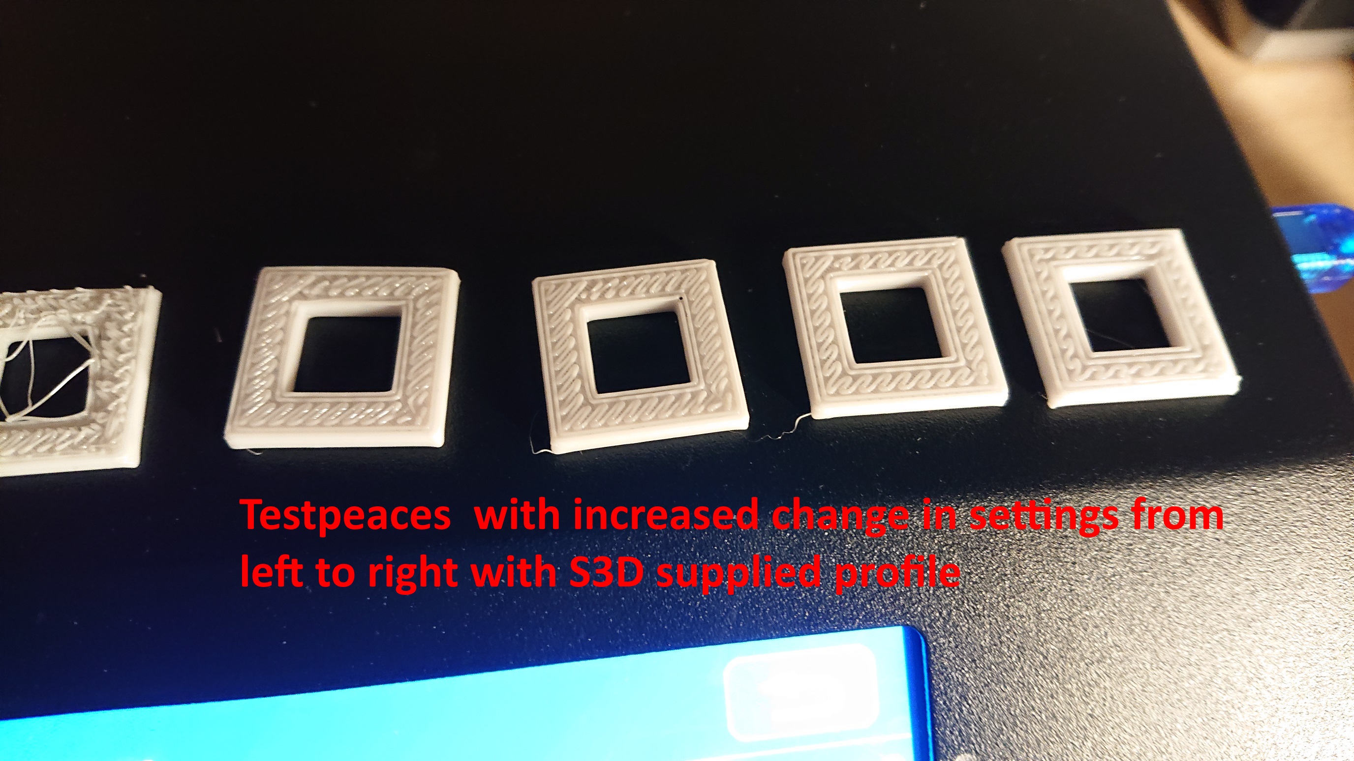

There were massive underextrusion problems. But only with the first layer. I was lacking time and after a while of trying to get it working lost any desire in printing, because it was really frustrating. Now we are two month later and I tried again.

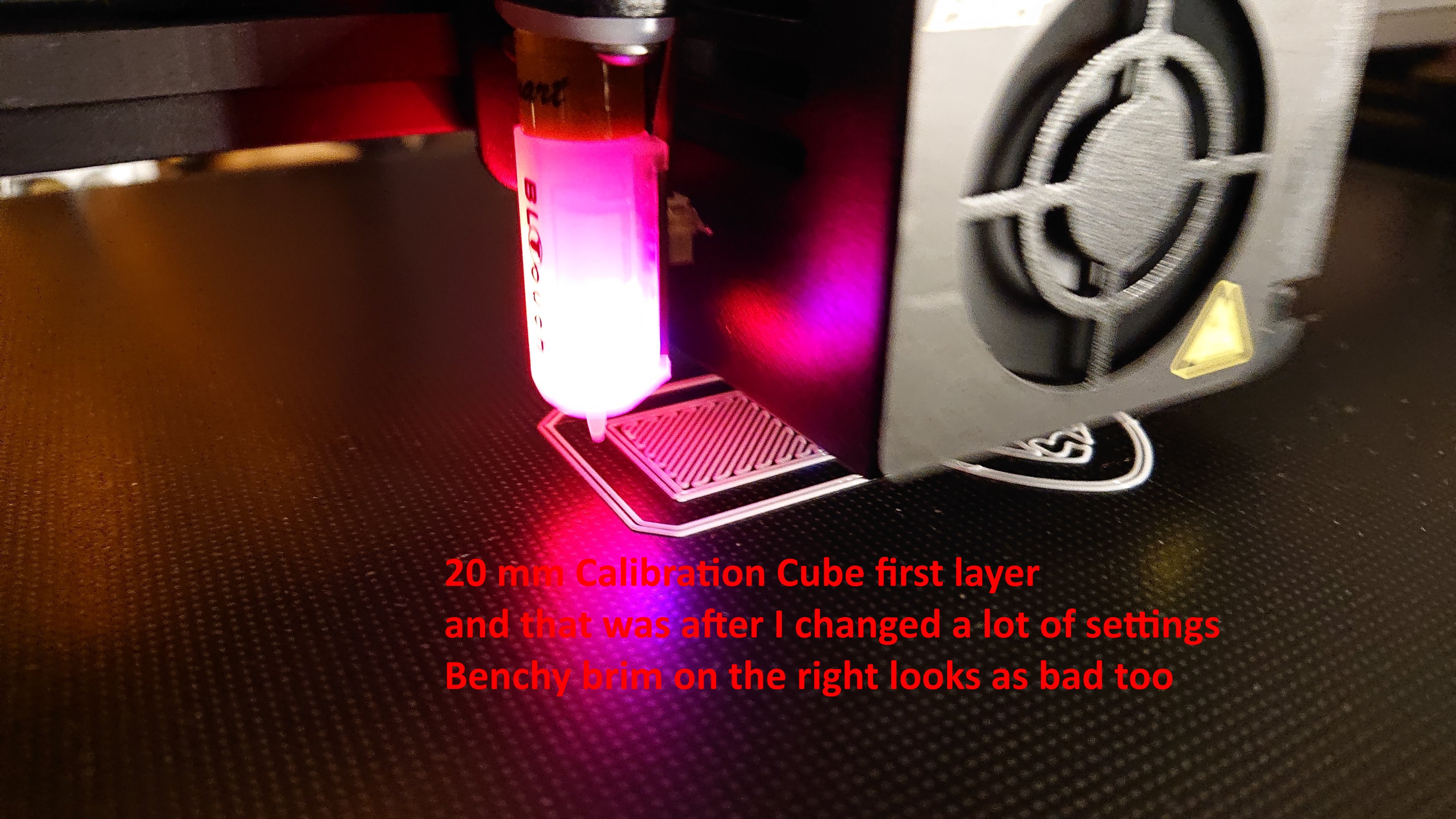

Same Problem as before. Layer adhesion is great. The starting script produces a nice line on the left side. But the brim looks like to lines side by side. The bottom of the calibration cube looks like 20% infill. A lot of diagonal lines with a lot of space between each one. The two outer perimeters are visible separated too. Again, only in the first layer. All other layers look an least ok.
S3D help page says it´s underextrusion. Yep, that’s what I too. So I rode everything about underextrusion and watched countless youtube videos about perfect first layers.
I changed "First Layer Height" from 100% to 90% then to 85% then to 80% - Step by step I changed "First Layer Width" to 150% and "Frist Layer Speed" to 35, then to 25. Yes, there was some very small progress. The lines are not so far from each other than before. But still not even near a closed surface. More like swiss cheese. So - hm - underextrusion. Okay "Extrusion Multiplier" - up to 1,05 (from 1.00). In the end I was at 1,30 with nearly no effect. I checked nozzle diameter settings, filament diameter settings, cooling setting and, oh yes, I changed "Infill Extrusion Width" from 100% to 120% - first layer infill is infill by any means. But no luck.
