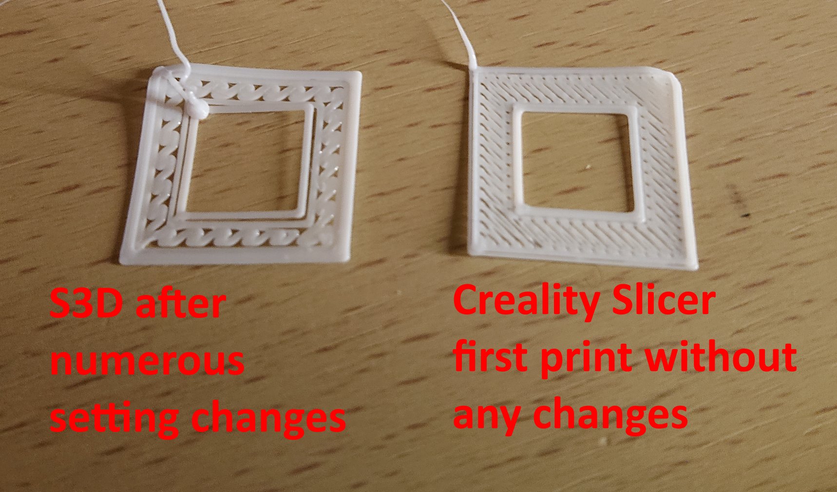

There were massive underextrusion problems. But only with the first layer. I was lacking time and after a while of trying to get it working lost any desire in printing, because it was really frustrating. Now we are two month later and I tried again.
Same Problem as before. Layer adhesion is great. The starting script produces a nice line on the left side. But the brim looks like to lines side by side. The bottom of the calibration cube looks like 20% infill. A lot of diagonal lines with a lot of space between each one. The two outer perimeters are visible separated too. Again, only in the first layer. All other layers look an least ok.
S3D help page says it´s underextrusion. Yep, that’s what I too. So I rode everything about underextrusion and watched countless youtube videos about perfect first layers.
I changed "First Layer Height" from 100% to 90% then to 85% then to 80% - Step by step I changed "First Layer Width" to 150% and "Frist Layer Speed" to 35, then to 25. Yes, there was some very small progress. The lines are not so far from each other than before. But still not even near a closed surface. More like swiss cheese. So - hm - underextrusion. Okay "Extrusion Multiplier" - up to 1,05 (from 1.00). In the end I was at 1,30 with nearly no effect. I checked nozzle diameter settings, filament diameter settings, cooling setting and, oh yes, I changed "Infill Extrusion Width" from 100% to 120% - first layer infill is infill by any means. But no luck.
I was really getting frustrated again. So bad that I actually use the creality slicer, that came with the printer.
And guess what. First print looks way better than any print with S3D. Yes, the first layer was thinner than on my old printer but not nearly as cheesy as with S3D. I tweaked only one parameter and that was gone too.

yes it does work, I'm using S3D with my ender 5+ without a problem.
Looking at your images it looks like your bed is way to far from the nozzle, make sure you calibrate the printer before complaining on the software ;)

I do not see how a misleveled bed can work with one slicer and not with another.
The printer bed was leveled several times the same way as shown in https://www.youtube.com/watch?v=zSOVAdKw4ss
After leveling you see the prints with s3d. Even after trying to solve the problem with the pictures shown in the support section.
Then I installed the original slicer and without changing or releveling it works way much better. After I changed flow, as I did in s3d, I got a descend print in the end.
I am not sure what is meant by " E-Steps " - if you mean if I calibrated the extruder then no. It didn´t occur to me that with a new printer that might be necessary. But in the end I increased the flow parameter in s3d as well as in crealitys cura version. While the creality slicer gave me a descent print the s3d print sticks barely to the bed.
