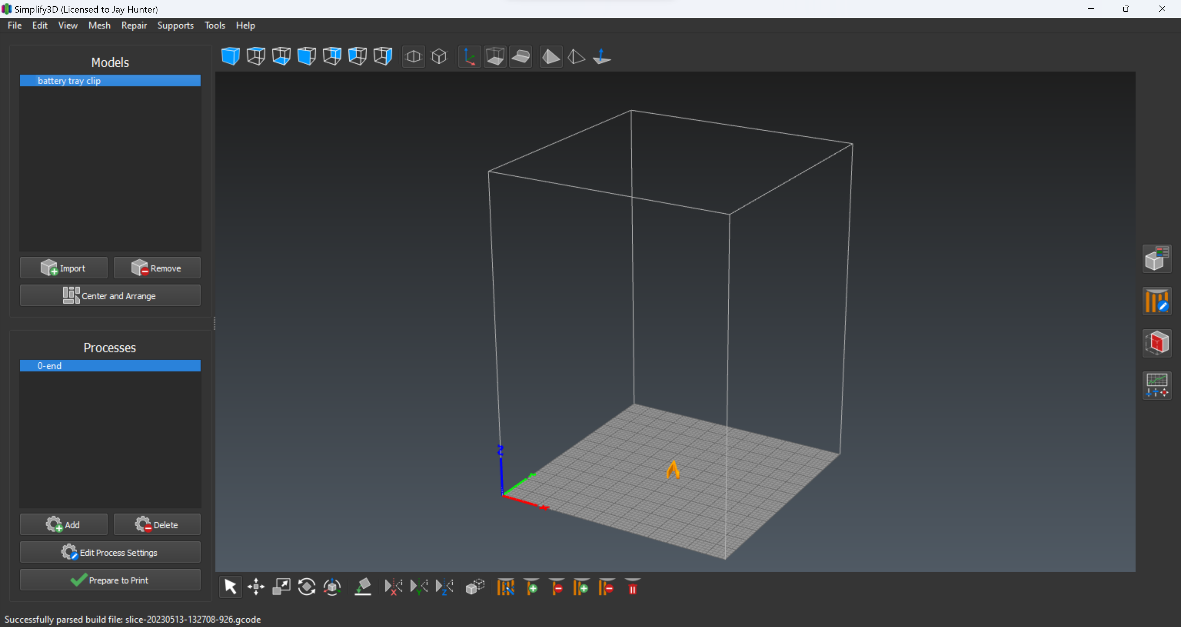

I just upgraded from v4 to v5.0.1 and this scaling issue still persists. In my case the S3D window needs to be re-maximised or docked every time I switch between the preparation & slicing interfaces. The bottom section of the interface is not accessible. If I apply "override - system enhanced" high DPI settings in Windows 11 the interface layout is fixed & remains persistent but is fuzzy in appearance. See screen shots.

Posts: 1610
Re: [FIXED] hi-dpi problem in windows 11
I would recommend creating a new post as the issue described in this thread was already fixed in a past release. The original problem was that text was being displayed extremely small on 2K and 4K displays, but that no longer happens with Version 5.0.1 and above.
It looks like you might be seeing something different where the window is too BIG, so it definitely sounds like a different issue. Please create a new thread and also try out the latest 5.1.0 release to see if that improves things.
