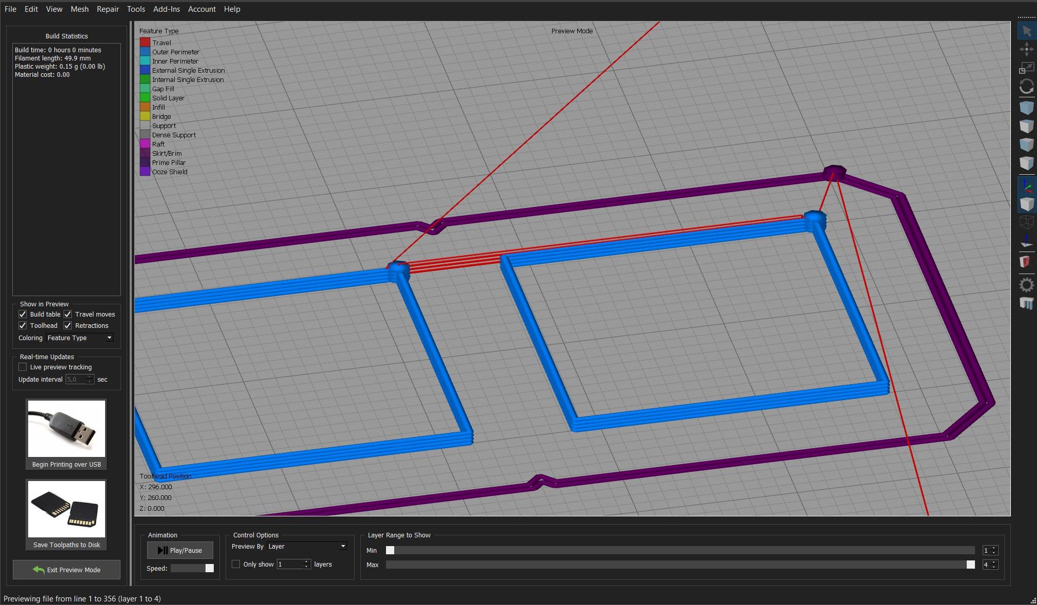

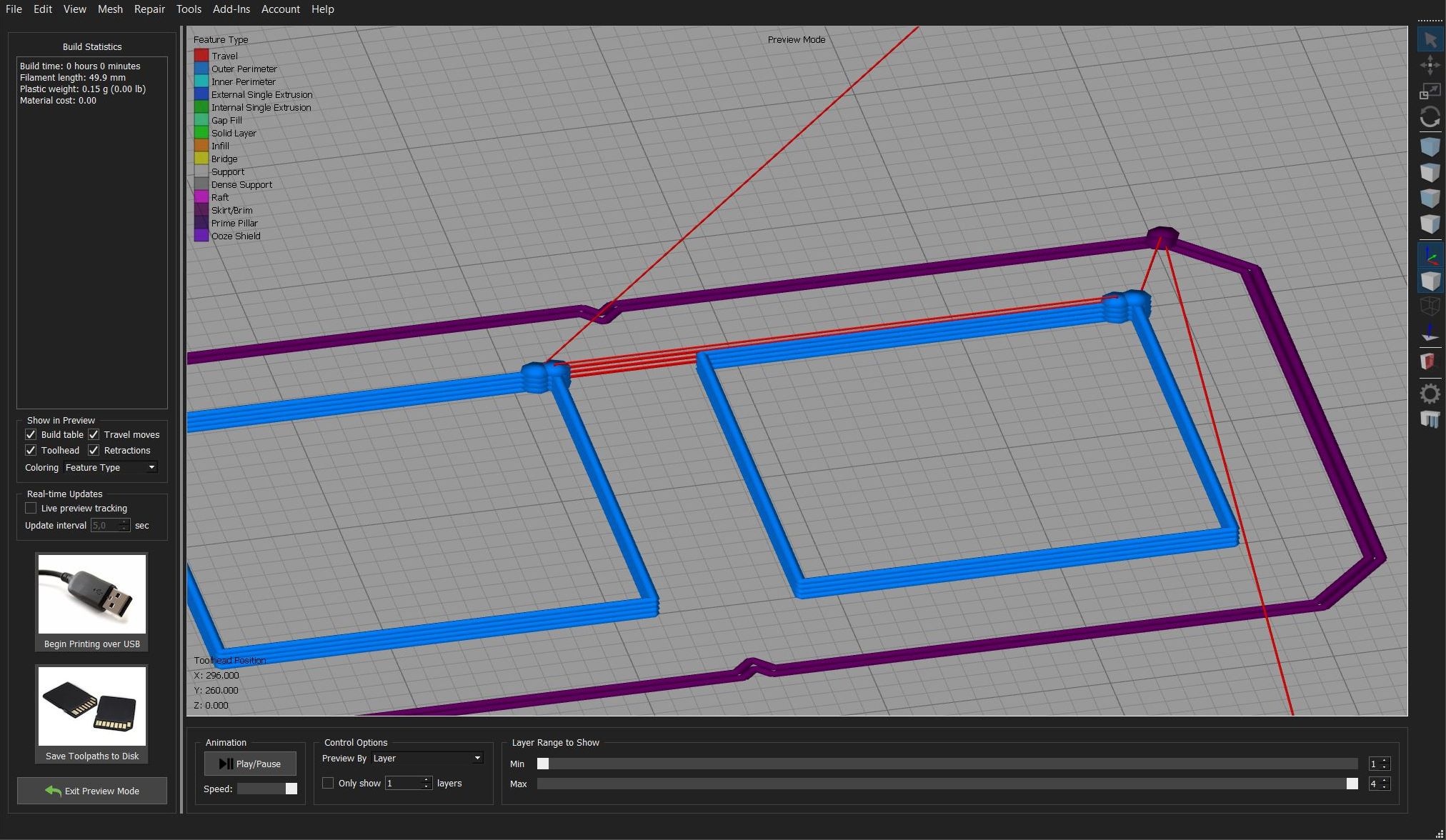

This can be seen in the preview - there's two retractions within a short distance (wipe distance):
retraction speed 40mm/s:
retraction speed 15mm/s
