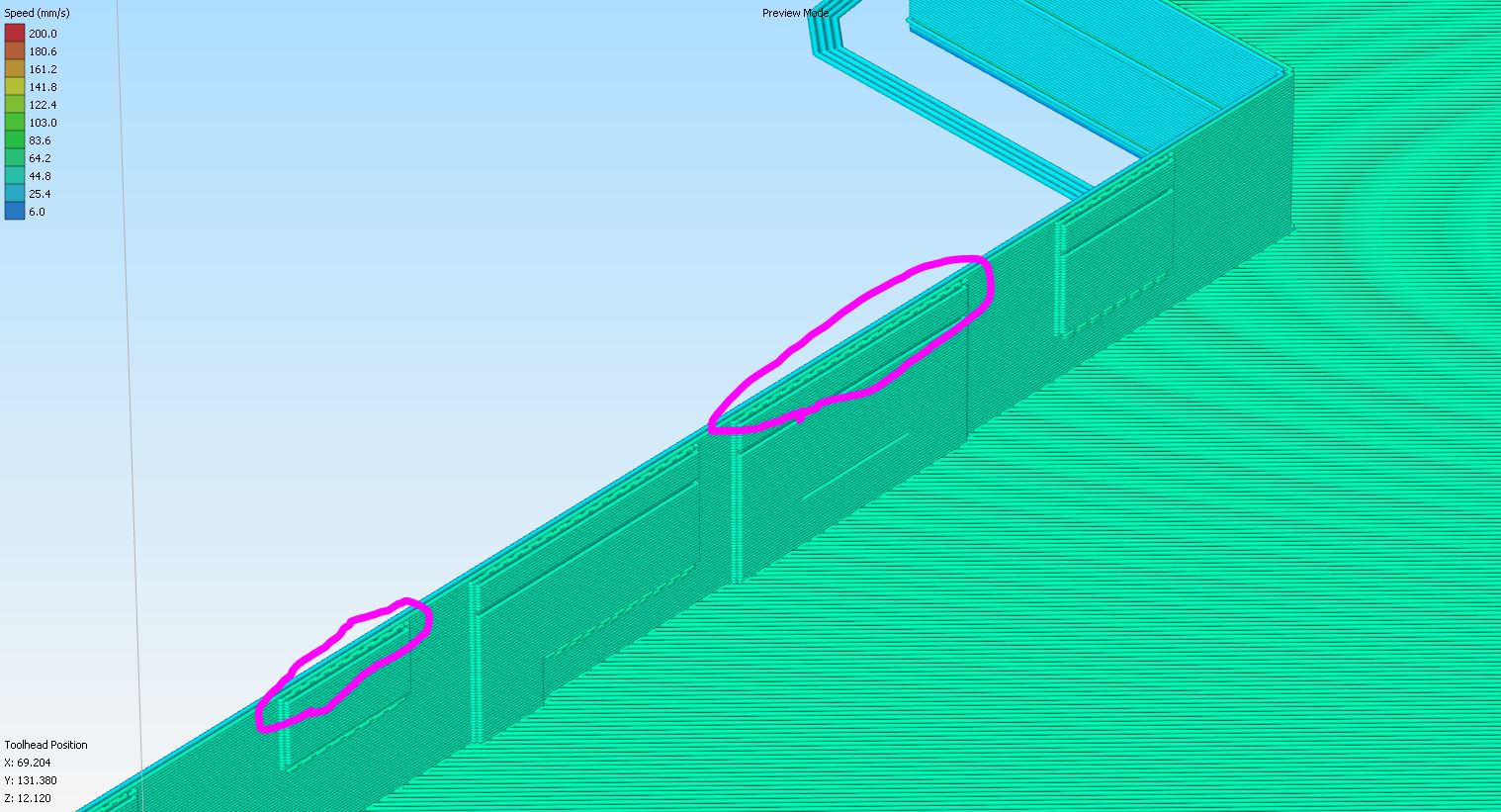

Hey guys,
I have a print of a building with exterior windows and doors.
For some reason, the slicer is placing "wiggle" type extrusion below and above each window on the inside of the perimeter shell.
I know from the past that this increases the chances of a clog/stoppage with the extruder rapidly retracting.
I understand that if the indent of the window was large, this would be needed, but I specifically made it shallow for this reason so I can have 1 solid shell. In the attached image, I turned off infill so that the issue is more clear to see.
Does anybody have any advice of how I can manage to get rid of this? Or an alternative option that I can use back in the design to avoid? This will be a large print, roughly 2' x 2' all printed in one shot (hopefully). And there are a TON of windows involved, so I need to do everything I can to avoid a fail 20+ hours into it.
I appreciate any help!

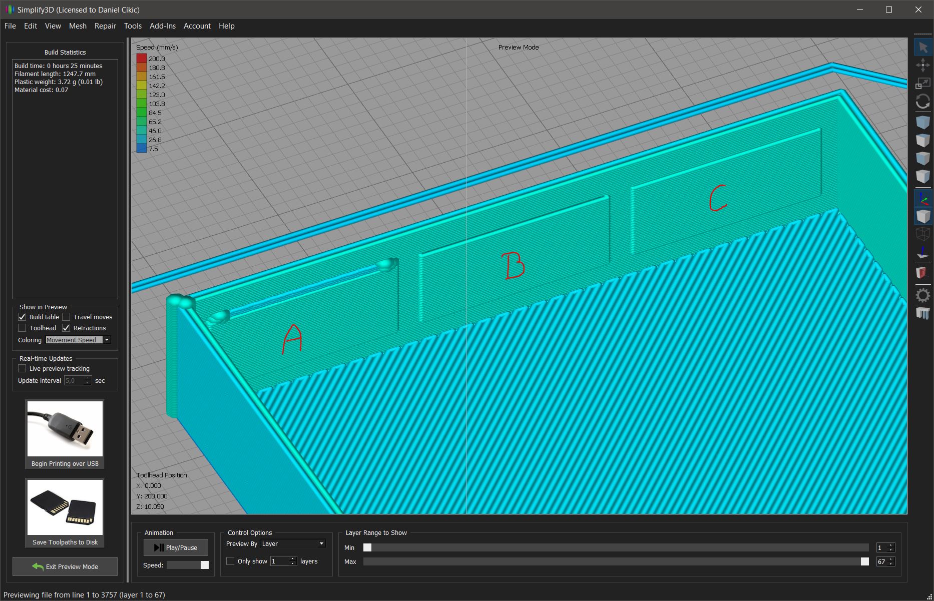

It's hard to tell from the screenshot... but if the windows are far enough "inside" the slicer might
try to close the resulting gaps with bottom/top solid infill.
Please have a look at this picture, I tried to recreate what I can see on your picture:
A = 0.5mm, B = 0.35mm, C = 0.25mm:

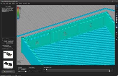

"A" does get some infill on top. Setting bottom/top solid infill layers to 0 gets rid of that. Maybe a process
covering the z height where windows are located can be used to set those to 0 and another process
can take care of other areas where you might need them....

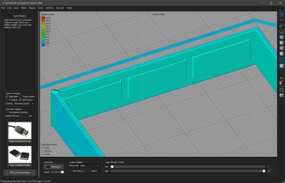

0 top/bottom solid infill layers:
Increasing the extrusion width slightly might also get rid of the infill lines.
