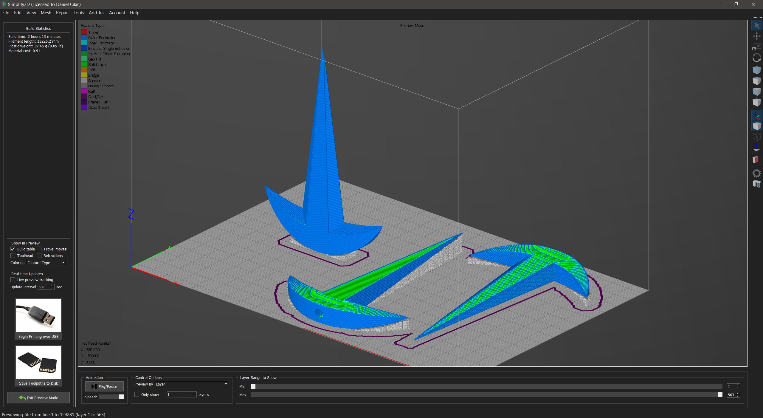

This is with the default crealty cr-10 settings. Not sure what to modify
Model is the blade from this thing https://www.thingiverse.com/thing:5266983

roundporch wrote: Sun Jul 10, 2022 3:44 pm Not sure what to modify
Try adjusting the support settings. Especially Support Pillar Resolution.
Does work, but resolution has to be small enough to support the thin tip of the blade.
Usually I avoid parts needing supports - so I may miss something here. But to me this does look like the worst
orientation this part can be printed at. Why not lay it flat on the blade or simply print it pointing upwards?!

Thanks for the reply, trying some different orientations. Edit -> Place Surface on Bed is a good feature to help with this
