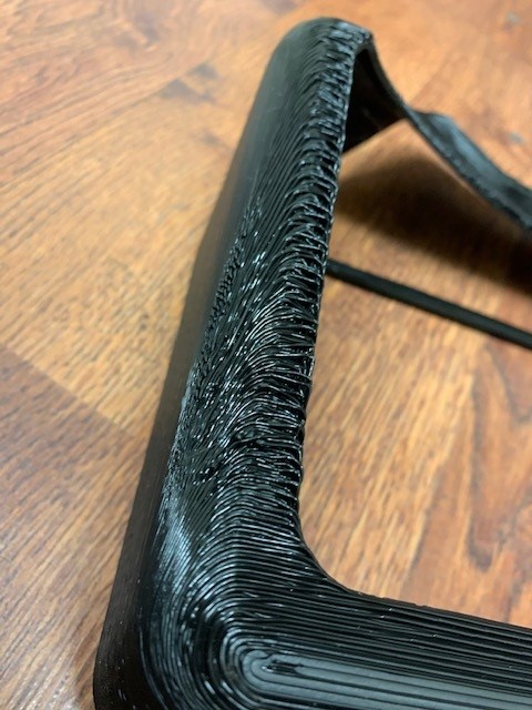

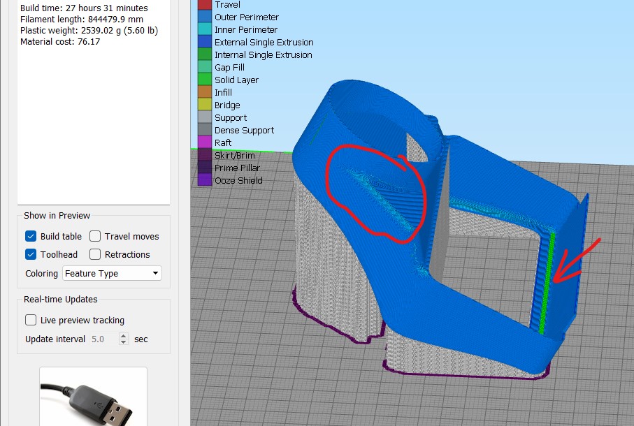

Hello everyone, i have been searching all over the support section and cant seem to find an answer to my question. I have read the "poor surface above supports" section and have done everything but nothing seems to be the fix. My main issue is attached in the pictures below. The area above all my supports are stringing too much and within the body it is clear to see each layer individually rather than being one solid part. If you look closely there you can notice that each layer is shown line by line rather than molding as one solid part. The printer is a Builder extreme 2000 with a dual printhead however there is only one extruder being used. I have tried turning the horizontal and vertical separation layers down however the supports end up sticking to the part. I have the print at a 28 degree angle because that allows the print to show all outside layers in the final printing process, I have attached a screenshot to show that the whole part is "blue" which i assumed is what is usually wanted. Here is the following information for the print settings:
-0.8mm nozzle
-PLA filament with1.75mm diameter
- extrusion multiplier: 1.15
- retraction distance: 4.50mm
-extra restart distance: -0.20mm
-coast at end (check) coasting distance: 2.00mm
-top solid layers: 5
-bottom solid layers: 5
-outline/perimeter shells: 5
-infill is on but the parts walls are too small to allow infill unless it is swapped to a 0.4mm nozzle
-horizontal offset from part: 0.7mm
-upper vertical separation layers: 3
-lower vertical separation layers: 5
-default printing speed: 4200 mm/min
-apply bridging settings to perimeters (turned off)
Change lower to 0 and upper to 1 and see if that helps.. Those numbers are the number lf layers to leave as space between the buildplate or part at the bottom and top of the support

I'm not remotely an expert yet, but did you try turning on the bridging settings on perimeters? I did that in your factory file, and it showed that most of that section in your picture would be a bridge. Bridging settings should keep that first layer cleaner on its own, and also allow you to move the support closer (0 and 1 as airscapes suggested) without the bottom surface drooping down into it as much.
Also, if you haven't already, I would recommend that you try out the dense support options. On something like this, I've had good luck setting the dense infill to something like 10 layers at 30%, and cutting the rest of the support down to 10% or 15%. It saves a significant amount of time.

That factory file still has a three layer support gap on a .27mm layer height, so that part still isn't going to touch the support until it sags quite a bit. If you get your bridges dialed in better, the filament won't fuse with the support as much and you can scoot the support closer to the part.
The dense supports don't have to be "dense", they just give you the option to print with sparse supports in an area that doesn't matter. Changing the support settings in that factory file to 10% support with 10 dense layers at your normal 25% cuts your print time by 25% and your filament use by 32%.

You said .8mm nozzle in your original post. .27 is a pretty heavy layer for a .4mm nozzle, so I'll assume your original nozzle size post was correct.
There have only been a couple of very unique situations where I used anything other than one separation layer. Anything more than that gets messy above the supports (like you're getting here).
My general rule of thumb is that if supported build bonds too tight to the support, increase layer thickness. If the build on top of support is messy, decrease layer height. Since support separation can only be set in increments of layer height, adjusting the layer height is the only tool you have to making fine adjustments to the support separation.
