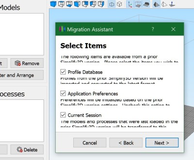

I have a 4K display that I'm scaling everything to 125% on. This works perfectly in every program I run except for Simplify3D where it seems like text gets scaled but nothing else, which makes text illegible sometimes.

Similar problem, very small font on Windows 10. Been using the Prusa SLicer recently, and needed to get back to simplify.
Some of the fonts are so small I can hardly read, and therefore hardly go through configuration... and I'm very disappointed.
