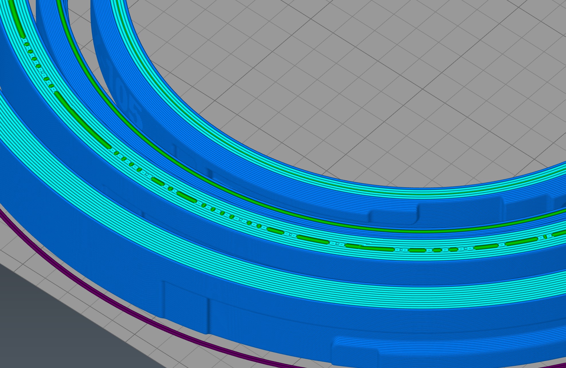

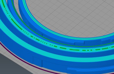

Was hoping V5 would eliminate these short segments
V4 does similar things. Was hoping it would go away in V5.

Can you post the factory file? I bet you could increase the Allowed Perimeter Overlap percentage by 10% and then all of those small segments would go away.

I sent a factory file to support already. Changing the overlap moves them to different parts of the print, but doesn't eliminate the short perimeter loops.
